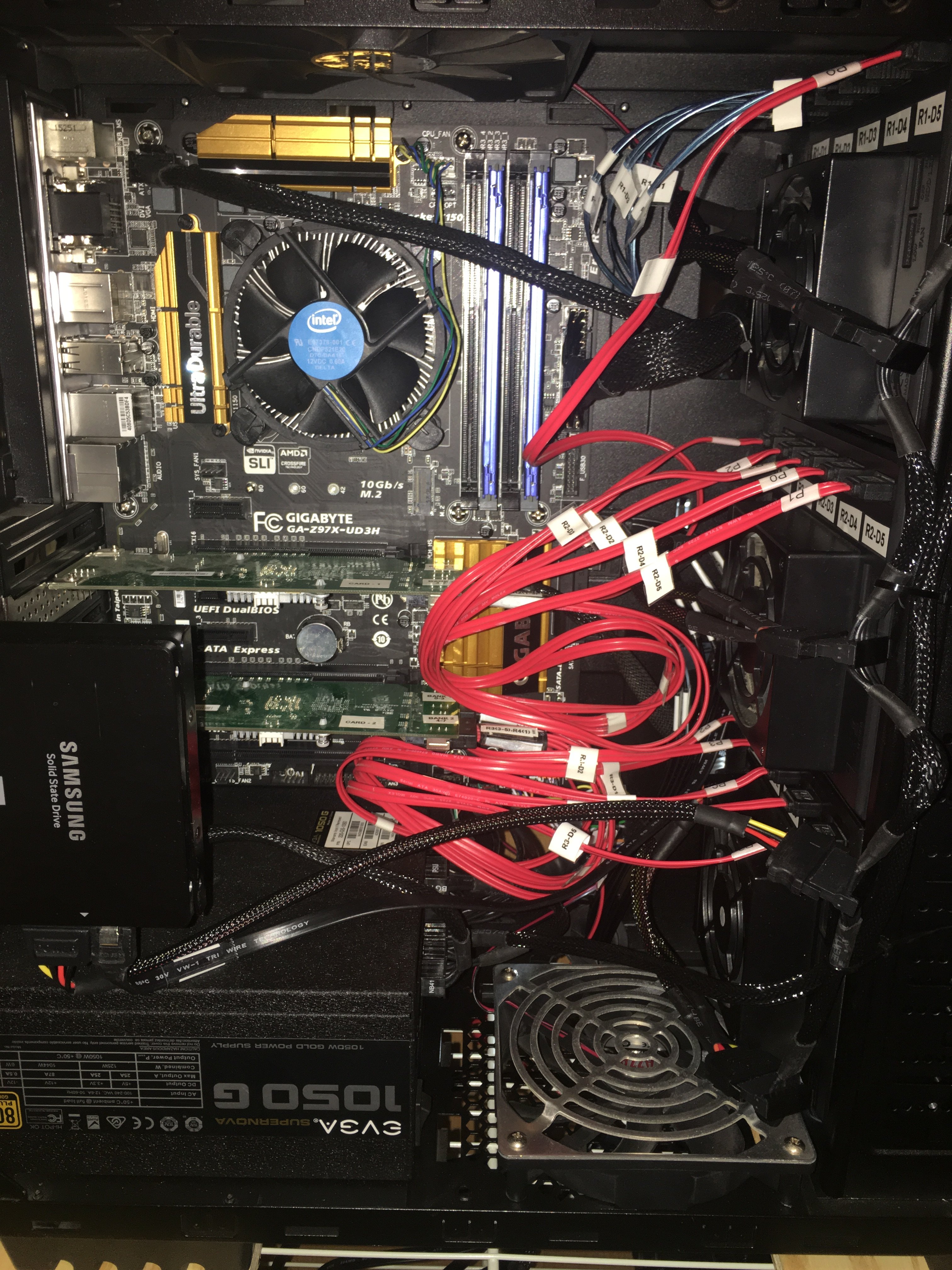

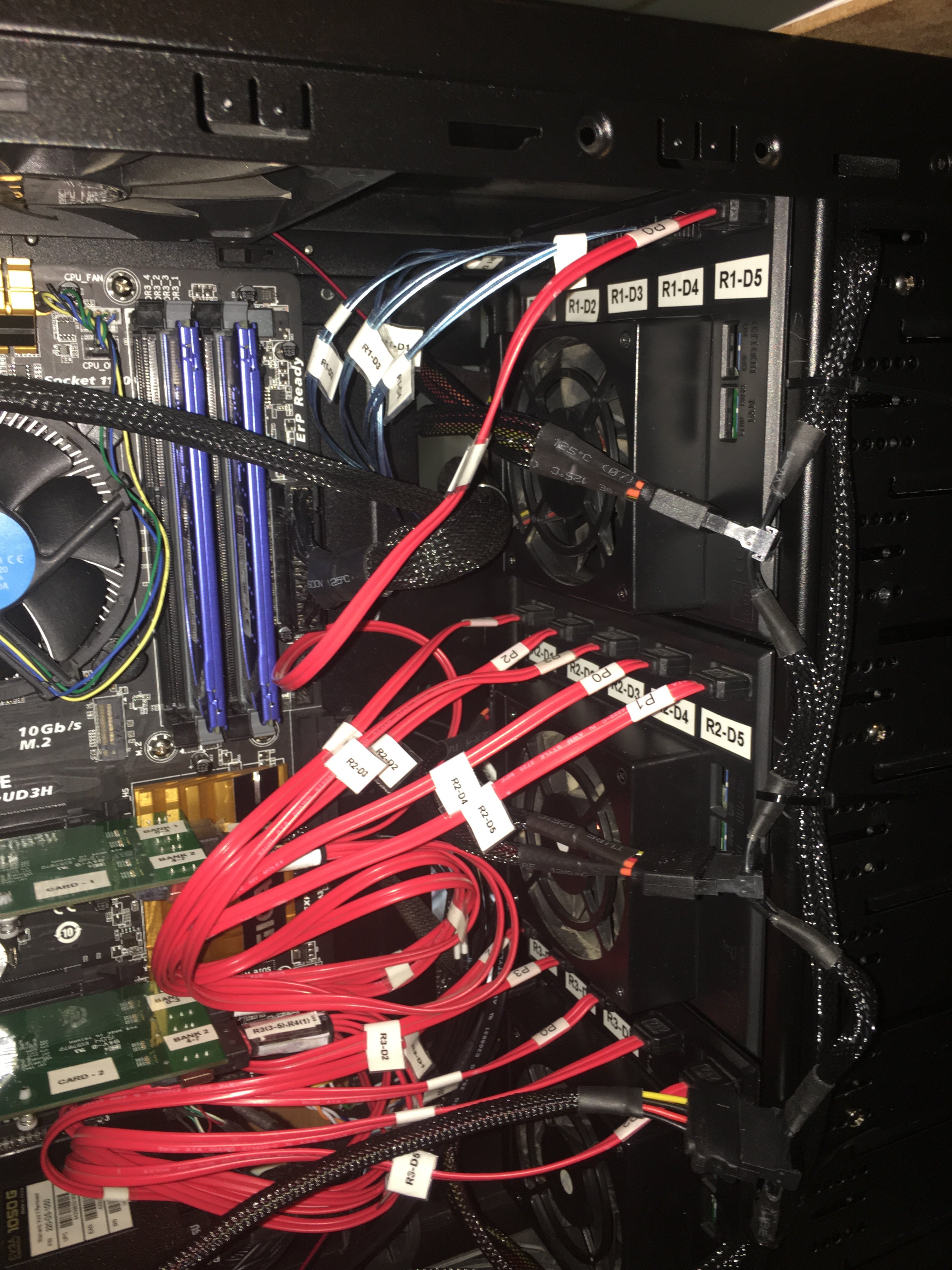

Do you, by any chance, have the SATA cables 'tied' together to make for a neater appearance of the server?
Nope, Infact here... Let alone nothing has changed since there were no errors at all, and then the error and I started changing out cables and a power supply. I did just order round cables and new breakouts...at the very least I'll have plenty of spares
