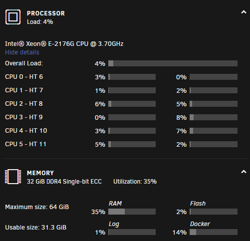

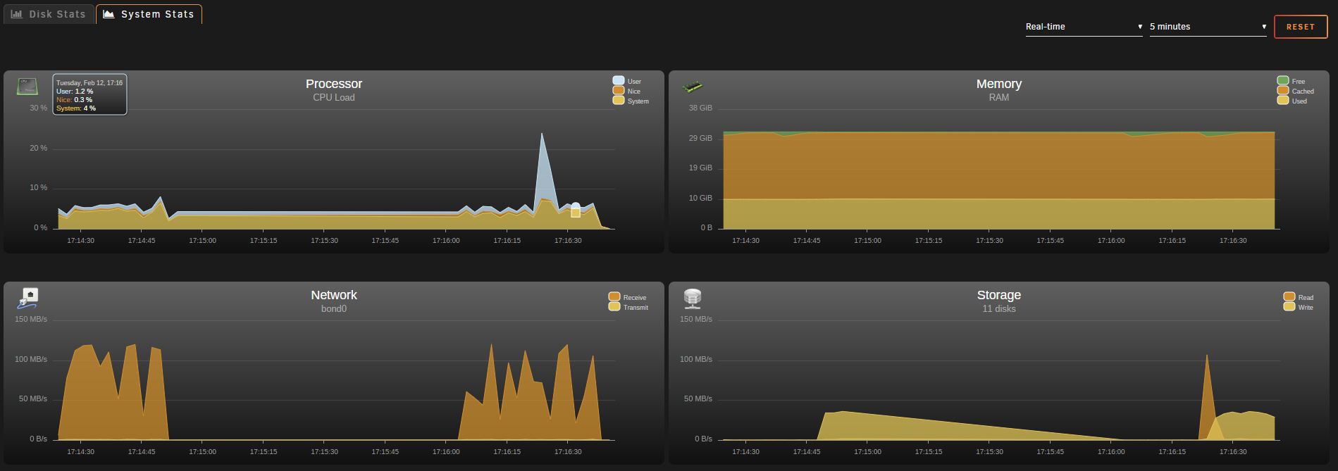

But to my surprise the UI freezes while copying data? But looking at the load it really shouldnt be a problem?
I initiated the transfer from my Synology to my new UnRAID server (Push)....
Am I doing something wrong?
All menu settings, WM etc runs slow.... have to wait for the share setting to load the full page and so on.....
