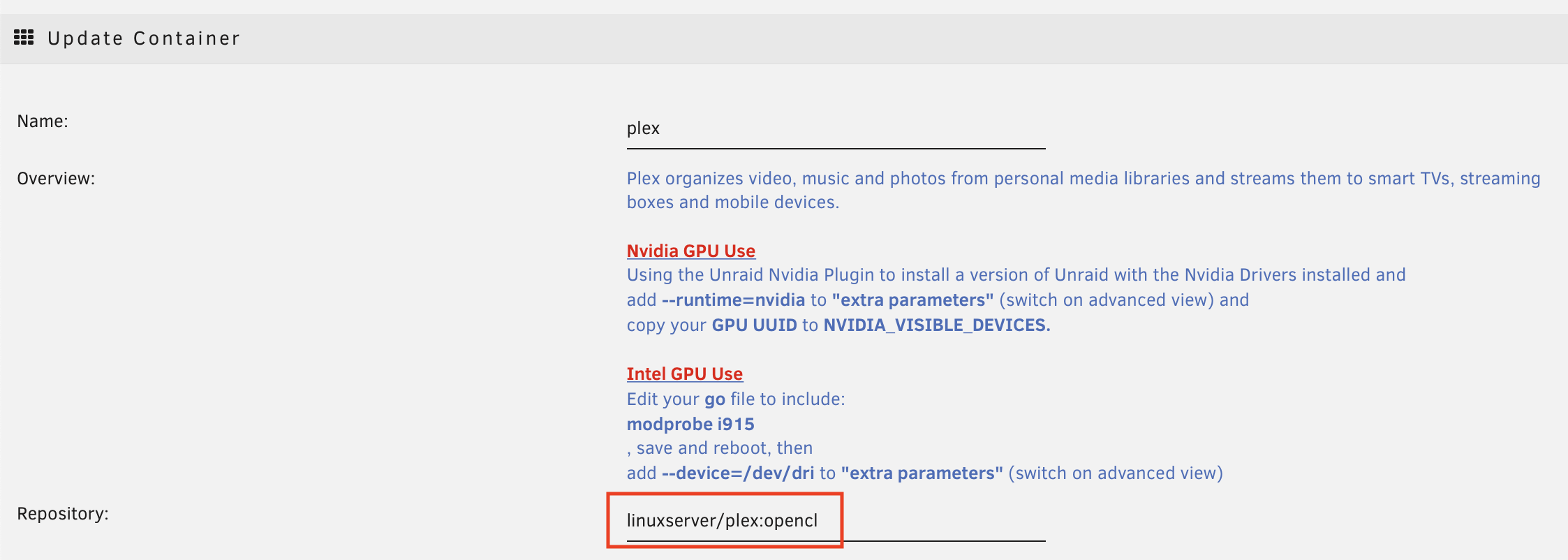

*** Update ***
So by investigate further, I could find that:
  • Plex team did update their code to support official Intel  NEO Runtime drivers
  • But the required minimal version for these Intel NEO Runtime drivers is 20.36 which are not just so simple to install
  • There was a new branch created on Linuxserver's Plex GitHub, allowing easy installation of this.
But it's not directly available from them using their Plex container app, yet.
Then I guess it will not take long to get this formerly available from them.
Waiting for that, if you want to go ahead and give it a try, there is a very simple way of installing this new release, which is much nicer than the script I proposed a few days ago:
Just run the following at your plex server prompt and wait for it to complete (like a few minutes)
docker build -t linuxserver/plex:opencl https://github.com/linuxserver/docker-plex.git#opencl
Change the image your container is pointing to by editing it and add ":opencl" at the end of the Repository option like in this picture:
It should take a few seconds to update your container using this new image.
Final Steps:
  • To update the container you need to build the image again, and go to Advanced View in the container listing tab, and force update for your Plex Container.
 docker build --pull -t linuxserver/plex:opencl https://github.com/linuxserver/docker-plex.git#opencl
  • To revert back to the original container, just remove the ":opencl" at the end of the Repository option.
Enjoy !

3 hours ago, drogg said:
So we don't need to run your script anymore (which worked wonders btw) and can instead just follow the new docker image?
Actually, the old script doing compilation eats CPU and takes long time to execute, at least in my environment, but it has the nice ability to be really adapted to Docker in Unraid, so it actually doesn't break anything (hopefully), and so can be used still.
The new script on the other hand, is much faster as no requiring compilation, and the GPU driver is officially supported by Intel, so by many aspect it's providing a better solution. But it's not fully adapted to Docker GUI in Unraid, and brakes the fancy container update process, so it requires a manual process for each upgrade of the LSIO Plex container
This is the full formal upgrade process by using this script:
Then from Unraid Docker tab, switch to ADVANCED VIEW mode with the little switch on the top right.
And then click on "force update" for the Plex container.
At the end you can choose which solution suits best your needs !
