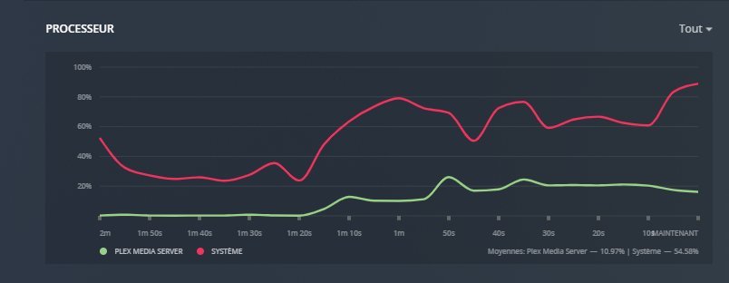

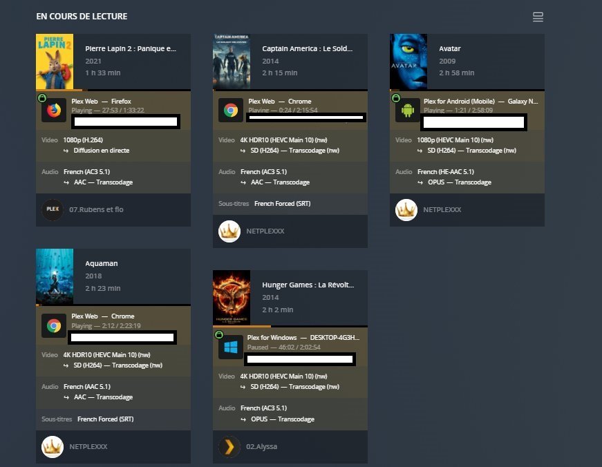

On 3/30/2022 at 11:12 PM, kalfun said:
You never transcode 4k, regardless if it's by CPU or iGPU. It just uses way too much resources. Always Direct Play. If you need to transcode 4k to play it, maybe you shouldn't be collecting it in the first place.
It worked before, I even did a tutorial on unraid (lien), I already did 6 simultaneous 4K>SD transcoding with 100gb files.
So no, it's not a resource problem!
And I think, the problem comes from PLEX because by disabling HDR MAPPING it works.
I am again transcoding several 4K sources with igpu and the processor is not very busy!
Just wanted to say thanks to OP for a very simple guide that worked flawlessly first time. Gone from 100% CPU usage for one transcode to less than 20%, on an i3-8100T. Transcode video quality is great compared to i5 2500k!
any solution? having the same problem and similar setup - active tone mapping will use the cpu and not the igpu :(
