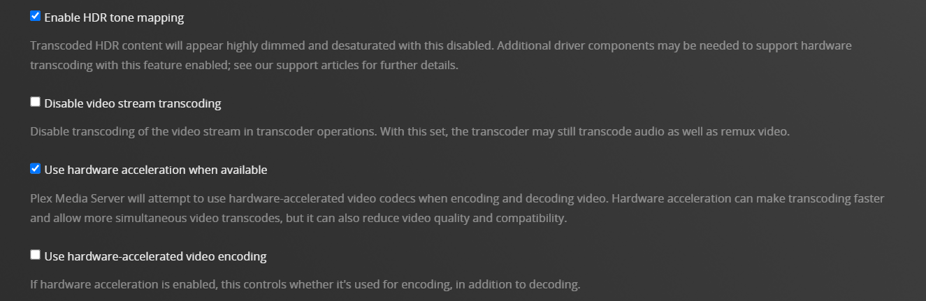

On 7/7/2022 at 4:47 AM, PsychoRS said:
Can you confirm hw transcode working fine with HDR tonemapping enabled? I have the same CPU and, with tonemapping enabled, only get the spinning wheel on the clients.
In fact, I have to check both hardware transcode options for hw transcode enabling.

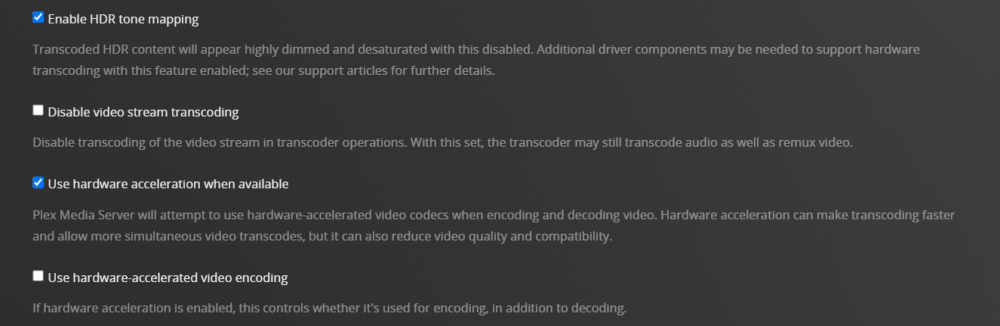

These are the settings that are working for me on the i7-11700k

My iGPU won't HW Transcode with Tone Mapping enabled.
Coffee Lake, i3-9100, UHD 630
Unraid 6.10.3
Repository: lscr.io/linuxserver/plex
VERSION: docker
Extra Parameters: --device=/dev/dri
I think the driver is loaded correctly:
https://imgur.com/D3Q7ukl
Transcode Settings in Plex:
https://imgur.com/FVXS8sY
I've tried it a few different ways, with the same 4k movie, quality set to 1080p Medium. I watched the Plex dashboard/Unraid CPU usage. CPU values are after giving it a minute or two to settle.
tone on, hw accel on, video enc on		4K HDR10 (HEVC Main 10) -> 1080P (H264)—Transcode				90%+
tone off, hw accel on, video enc on		4K HDR10 (HEVC Main 10) (hw) -> 1080P (H264)—Transcode (hw)		2-30%
tone on, hw accel on, video enc off		4K HDR10 (HEVC Main 10) (hw) -> 1080P (H264)—Transcode			40-60%, spikes to 90
Should I be expecting this or better? I thought the UHD 630 could do tone mapping but as soon as it's enabled it's offloading to the CPU.
I'm not really planning on ever transcoding 4k movies (the library is not shared with anyone but myself) but I don't like when things aren't working when they're supposed to 🤣

This is currently broken in Plex. You can either install an earlier version of Plex (forget which one) or wait for Plex to finally fix this. It’s been broken for about 6 weeks I think.
Ah, well if it's an issue everyone is having and not just me then I'll live with it. They've introduced stuff like edition tagging within the last 6 weeks so I'll stay with a current release.
