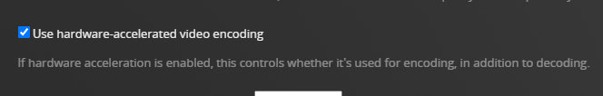

On 2/28/2022 at 12:46 PM, Dural said:
I seem to be having the same issue with an 11500T, h264 starts up immediately and shows hw encoding.  When I try to do the same on an h265 file it shows it starts and shows hw encoding but the client just sits there spinning.  It looks like the cpu has one thread that goes to 100% while the gpu shows no load.
edit-Just figured it out, uncheck Use hardware accelerated video encoding but leave Use hardware acceleration when available checked.  Immediately worked after doing this and cpu load is <20% (4 threads being used for VM so not necessarily just from transcoding) while gpu video load is ~8%.
On 2/28/2022 at 3:15 PM, Dural said:
So what it appears to be doing is using the QS hardware for decoding but the CPU for encoding.  If I turn the hardware encoding on it will work for anything h264 but h265 just spins, plex shows it's transcoding but nothing happens and 1 CPU thread is maxed out.  Issue with the current drivers for 11th gen hardware?
So I decided to try the hardware accelerated encoding again and it now works.  I haven't changed anything other than updating Plex, so it must have been a Plex issue.  I've got HW for both the decode and encode now, gpu gets hit hard and the cpu isn't doing anything.

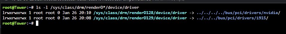

I have a intel 12600k and nvidia 1050ti in my system. When I do:
ls /dev/dri
ls /dev/dri
I see both the intel gpu and nvidia gpu. How do I correctly point the Intel GPU to Plex?
ls /dev/dri
ls /dev/dri
I found the solution. When you type:
ls -l /sys/class/drm/renderD*/device/driver
you get the following result:
1612077101_AfbeeldingvanWhatsAppop2023-01-26om21_00_08.jpg.36361cd3dd27acb8d934d3b693867eb3.jpg
There I could see renderD129 was the intel device.
To let PLEX use this, you need to add the following to the Preferences.xml file in de appdata folder of PLEX:
HardwareDevicePath="/dev/dri/renderD129"
Which looks like this:
93249927_AfbeeldingvanWhatsAppop2023-01-26om21_00_56.jpg.e46fbb1cb1f1375327b8dcbcaca50fd4.jpg
Then a reboot of PLEX, and the iGPU does the transcoding.
This just helped me, thank you!
