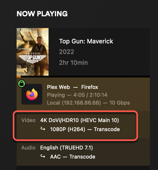

I stumbled upon this thread as I'm having issues using HW transcoding when HDR tonemapping is enabled in Plex (using the hotio container). I have an Intel i3-10100 CPU with quicksync, and am running Unraid v6.11.5. HW transcoding works flawlessly in all other circumstances.
Are there any recurring issues with HW transcoding for HDR tonemapping that might cause this? Or is it more likely to be my config? I have /dev/dri/ mapped as a device in the container itself, then:

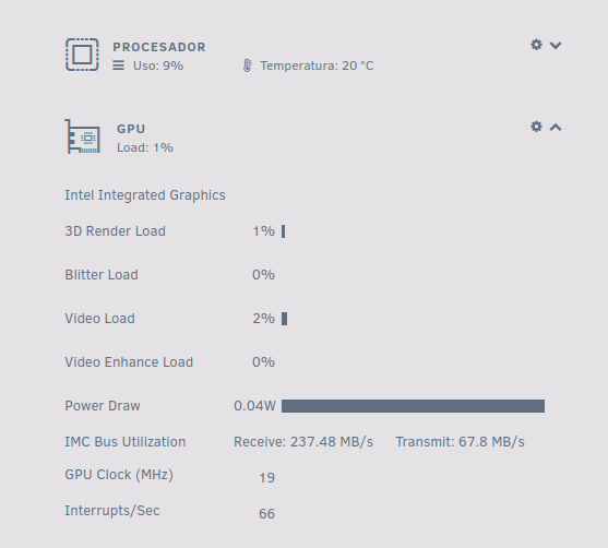

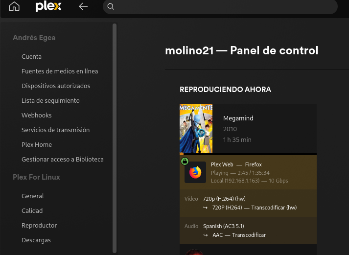

Thanks a lot. Could I use this trick with Tvheadend?
Edited by decibelio99

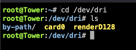

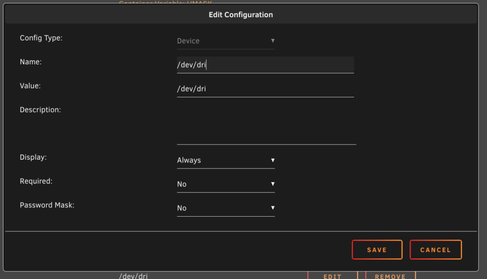

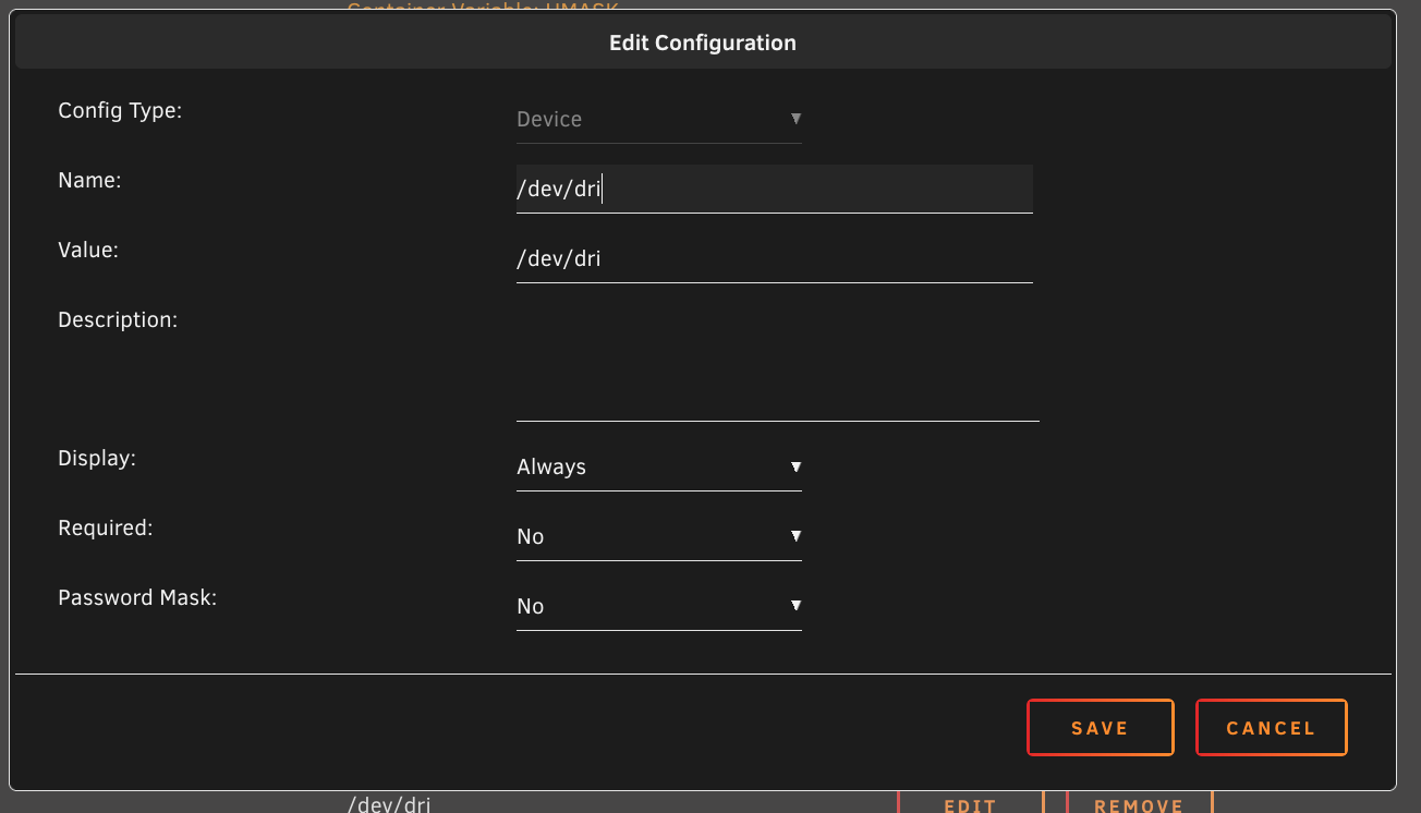

hello, i have just upgrade to a i5 13500 and prime z790 mobo. i have been trying to get Quick sync to work, but just keeps buffing. i have added --device /dev/dri:/dev/dri to Extra Parameters. i have edit the go file and no luck. i thick i have missed something could someone help me. as i had amd ryzen chip before and p2000 with no problem

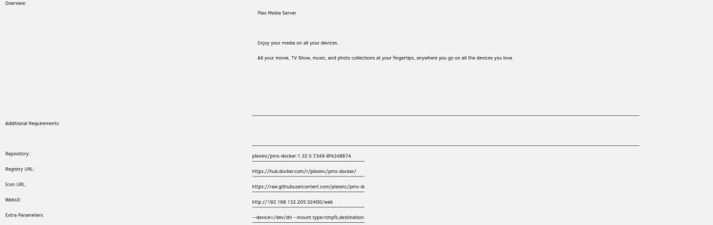

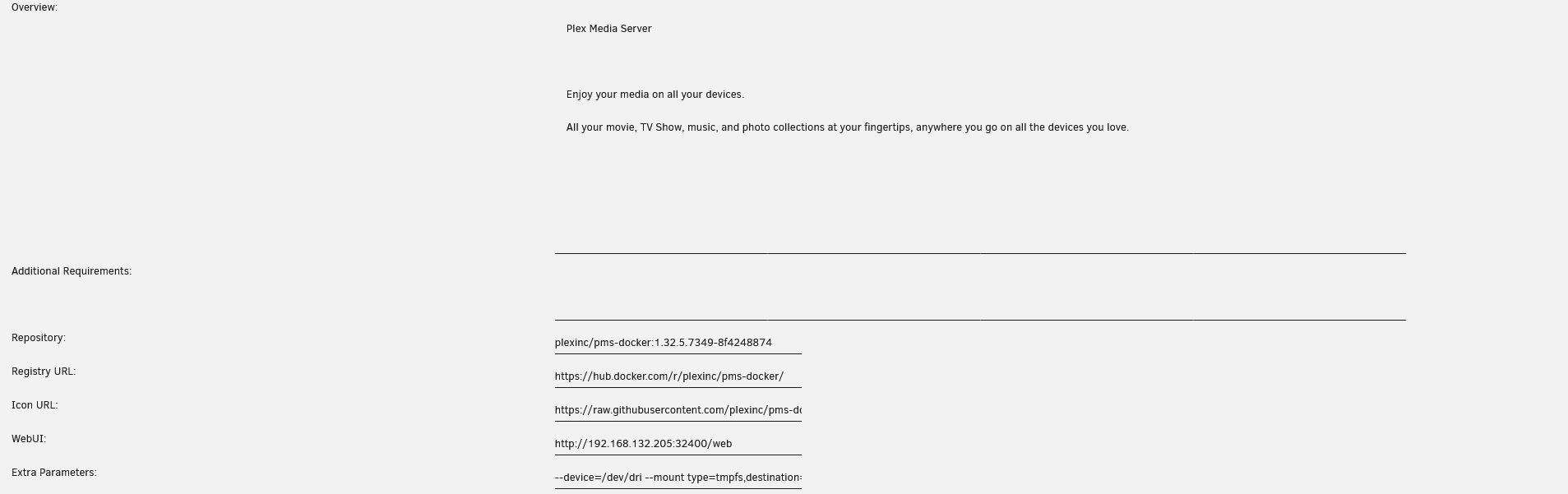

 I tried but I think I may be rolling back incorrectly.  How did you roll back?  All I did was change the following:
I am using the Plexinc template:
Repository: plexinc/pms-docker:1.32.5.7349-8f4248874
It's the same way you doing it.
Edited by eendenhart
