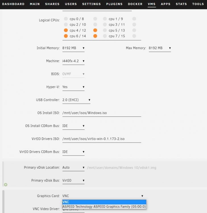

Hello folks! Since i could not get plex Hardware Acceleration running i really could need some help.
I tried to execute this guide but get errors right from the start.

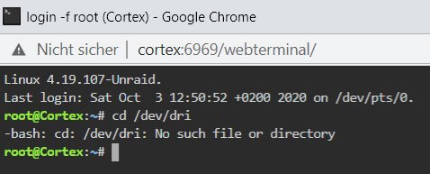

Checked my setup with:
cd /dev/dri
gives me already this error in the unraid terminal:
since i could not see card0

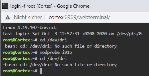

i typed modprobe i915 followed by again:
cd /dev/dri
and again got the same message:
Since i feel like i have all requirements, i have no idea what could be the mistake - or missing.
Quick overview for your help guys:
  • Plex Pass and Plex Hardware Acceleration enabled
  • Intel CPU with Quick Sync (Intel Xeon E-2278G)
  • Motherboard Setting: Primary Graphics Adapter: Onboard VGA (VGA is plugged to TV to see boot screen etc.) - i dont have hdmi on the MB.

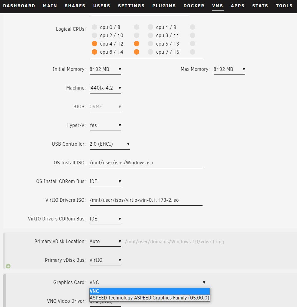

    • Is this already a problem? I also do not see the iGPU in my VM - i only can choose ASPEES AST2500 (BMC Controller) - Is having this a problem?
    • I heared something about headless ... ? Unraid need my iGPU?
Now i am afraid about this comment:
ome machines like the HP MicroServer Gen8 have iLO / IPMI which allows the server to be monitored / managed remotely.
Unfortunately this means that the server has 2 GPUs and ALL GPU output from the server passed through the ancient Matrox GPU. So as far as any OS is concerned
even though the Intel CPU supports Quick Sync, the Matrox one doesn't. =/ you'd have better luck using the new unRAID Nvidia Plugin.
So is this maybe the reason for no iGPU passthrough and the aspeed Graphics output in my VM instead?
So do i need a graphics card? Any recomendations? Quadro P2000 - or is a gaming GPU better if i want to use it too in a Windows 10 VM?
Guys i really appreciate your help! Thank you so much!
Kind Regards!

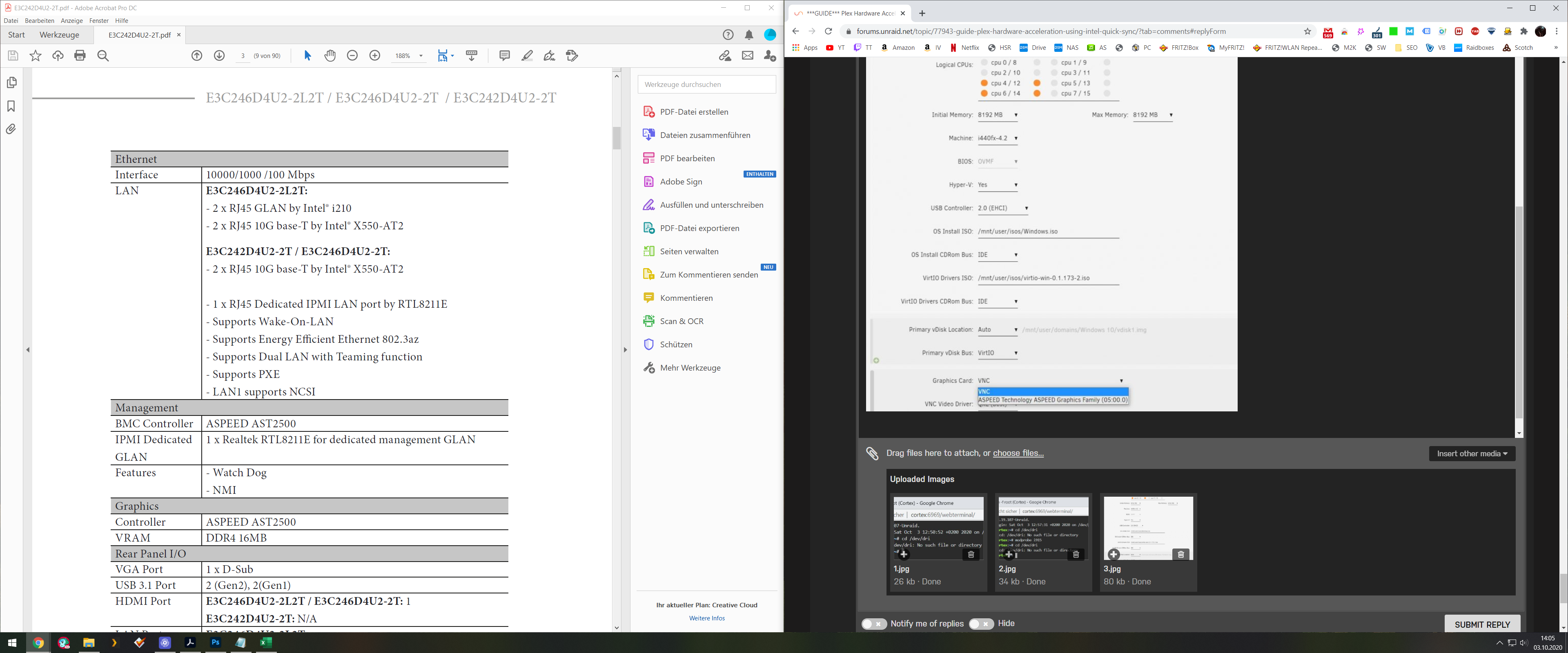

Hi @Mor9oth.  I see in your image it looks like you have an image stating you have the ASRock E3C246D4U type motherboard?  If so, and depending on what CPU you are running, you can have a look at this thread regarding the capabilities of that motherboard.
Intel Socket 1151 Motherboards with IPMI AND Support for iGPU
This is my Bios version:   So the fix (Support Intel Mehlow Refresh CPU (E-2200 Series) should be already in, right?
Even though the CPU has an iGPU, I don't think the C242 chipset supports it properly for transcoding.
I have an E-2288G CPU and an ASRock board (E3C246D4U) with a c246 chipset and it all works great there; however, I had to get a special BIOS from ASRock that supports the iGPU for transcoding as the regular BIOS does not because of IPMI video through the BMC.
I do not think the C242 chipset has this capability and that may be your problem.  At a minimum you would need a special BIOS from ASRock, but, again, I think the chipset is the problem and they might not have a BIOS that will help you out.
Thank you @Hoopster for your reply!
If you are right - that would be really sad - because i bought this CPU because of Quick Sync. So does this issue also mean that the iGPU works nowhere in the unraid enviorment (Docker, VMs, etc.)? 😵 I ask because this iGPU is also not selectable in my VM. Is this for the same reason? Is there a way to get it work - maybe without IPMI ...
So it seems that the only solution is to buy a dedicated GPU for Hardware Acceleration. For this i would choose the Quadro P2200. Since i also want to use the GPU for VMs i would be happy for any recommendations. Something like a GPU for VMs, transcoding (Plex, Handbrake) and maybe gaming.
Other Option could be to sell my motherboard:  E3C242D4U2-2T and buy the 246 Version of the Board: E3C246D4U2-2L2T. Then i could use my igpu - but how does it even perform compared to a dedicated GPU? P2000 should be stronger anyway, right?
Selling my Board would also probably mean losing Money too ... and the boards are quite simular too ... damn ...
what would you do?

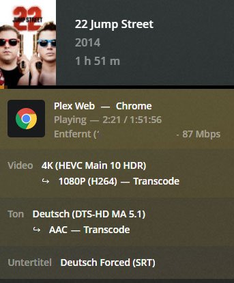

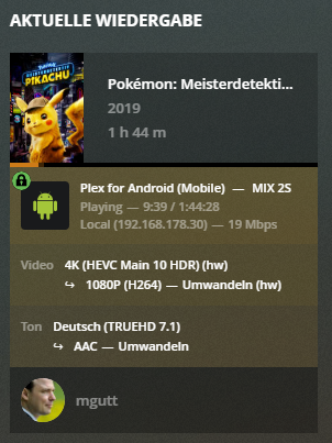

What does it even mean for the CPU workload to transcode with CPU only compared to iGPU (Quick Sync)?

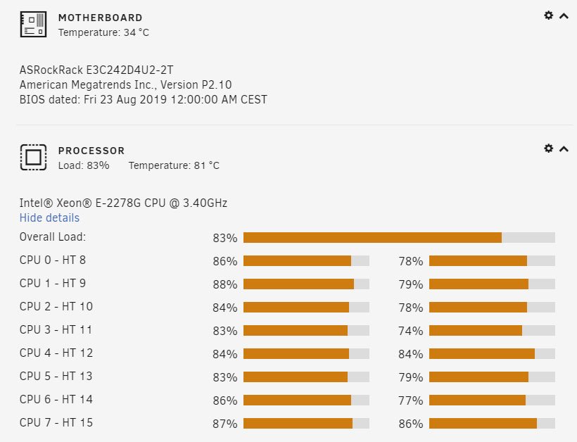

Example: Here I transcode a 4K Movie to 1080P without Hardware acceleration:
My CPU sounds like a Jet engine and is super high in load and temperature:
(An notion: Since the server is in the living room - this isn't really a thing I can live with)

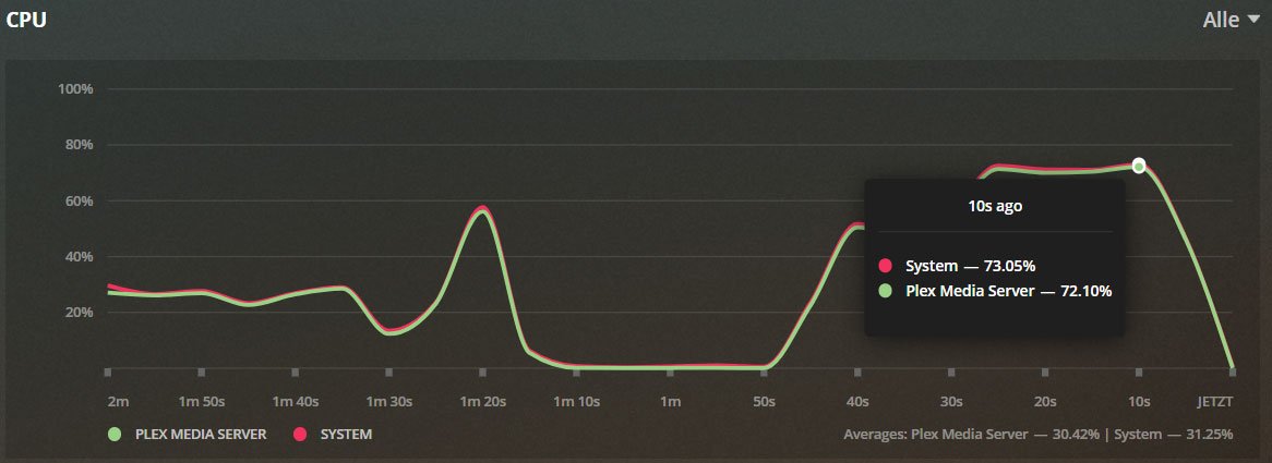

If I used the iGPU (UHD P630) for the same transcode how would this look like? I mean the iGPU is on the CPU. Would I have better temperatures and lower load? Resulting in quieter server? And what if I transcode with the P2000? The GPU should be quieter than my 4 Fans spinning up under load, right?

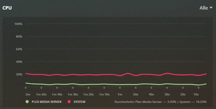

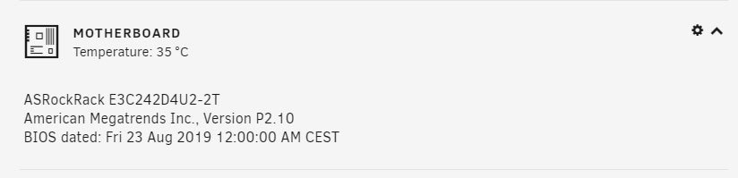

My system load is high as my two unraid servers are syncing, backup to cloud is running and parity check is running on all disks. So look only on Plex's load. Nice, isn't it ;)
Well, now I am pretty jealous! 😆
This is how it looks on my Dashboard: while transcoding:
