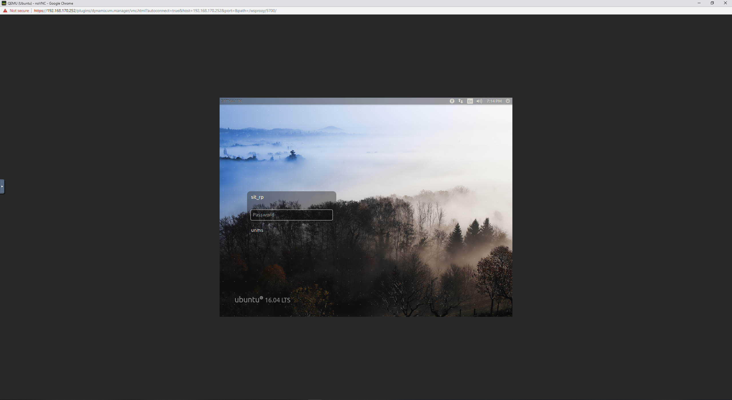

The same thing happens whether I try to connect through Unraid GUI or different VNC client. It gets me to the login page and when I punch in the password, redirects me back to login prompt without any error. All other VMs are working properly. I tried removing VNC Config from xml file of the VM, and adding it back, but that didn’t make a difference. UnfortunateIy can’t boot with the GPU because when I pass one through to this Linux Server, nothing is displayed on the screen, so I guess drivers are missing.

Post a screenshot of the login page with no credentials entered.

Here it is. When I enter my password, screen goes blank and I am back to the same page.
That's not a VNC issue, it's the VM itself.
To recover you need to use the same options as you would with a bare metal 16.04 install. Nothing to do with unraid's VNC server.

Yeah that's what I was afraid off. Since I can't hook up a monitor directly to it, I wasn't sure, but most likely same issue not being able to log in all the way. Thank you for your help.
