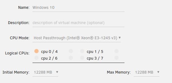

Shot in the dark: during the process of initial windows install and update, in VM settings for the VM assign a single cpu0 core.  Please report is this gets you past the initial install stage.
Have the VM now put on a Core.
see image!
Thought the Core 0/4 are intended for Unraid?
The installation is started and the system just loads all updates ..
see image!
You're saying that worked?  It's not so much which core is assigned, I think what's important is there is only 1 core assigned (and I guess it's ok to assign both hyperthreads).  This is a quirk of windows installer.  Probably what's happening is that some legacy code is being used at some point which is able to put machine in state where only a single core is active, perhaps to solve concurrency issue, and for some reason, this code doesn't work in VM environment - that's my theory anyway.  I've found that once the initial install completes, you can assign whatever cores you want and subsequent windows updates seem to work ok; but I must confess, I always get "worried" about the major yearly updates ;)
btw: unless isolated via kernel parameter, Linux (unraid) will use all cores.
