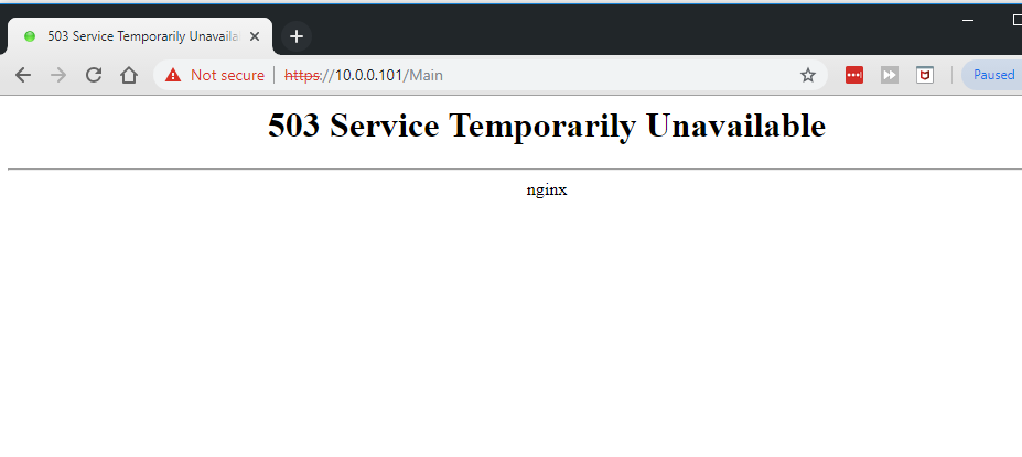

503 Service Temporarily Unavailable
Hi there
I need some help.  When I try to logging onto my Unraid 6.6.6 I get this 503 error. I've tried both Chrome and IE 11 and it happens on each. I can still access my shares and see files. I can also access via SSH and the last thing I did was run a parity check which was supposed to finish earlier on in the day. I'm not really sure how to troubleshoot this.
Annoyingly my instant thought having worked in IT was to power cycle it however that made no difference and I'm going to say that has probably killed off the logs.
Any advice would be much appreciated.
Thanks
