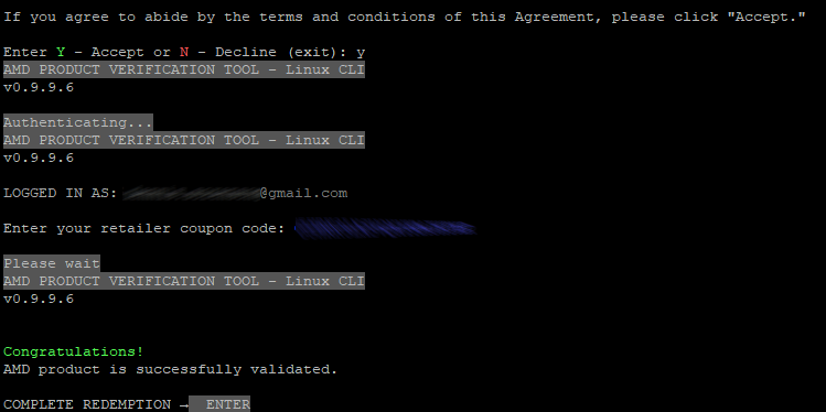

Just wanted to give another option as I just did it.
Option #1:
From a Linux machine, go to their tool site:  amdrewards.com/pvt.  Download and you should be prompted to save pvt.sh.
Throw it into a directory in UnRaid, open a shell, chmod 777 pvt.sh, then sh pvt.sh.  Follow the instructions.
Option #2:  (What I did.)
From a Windows machine, install a user agent addon to change the browser's user agent to a Linux signature.  When you click the download button, you'll be prompted to save the pvt.sh file.
I believe the pvt.sh file is built on the fly when you download it as I didn't have to sign into the tool.  So I'm sure the installer can't be past around to just any Tom, Dick, or Harry.
At that point you can log into https://www.amdrewards.com/my-rewards.   You should be able to complete your reward at this point.
