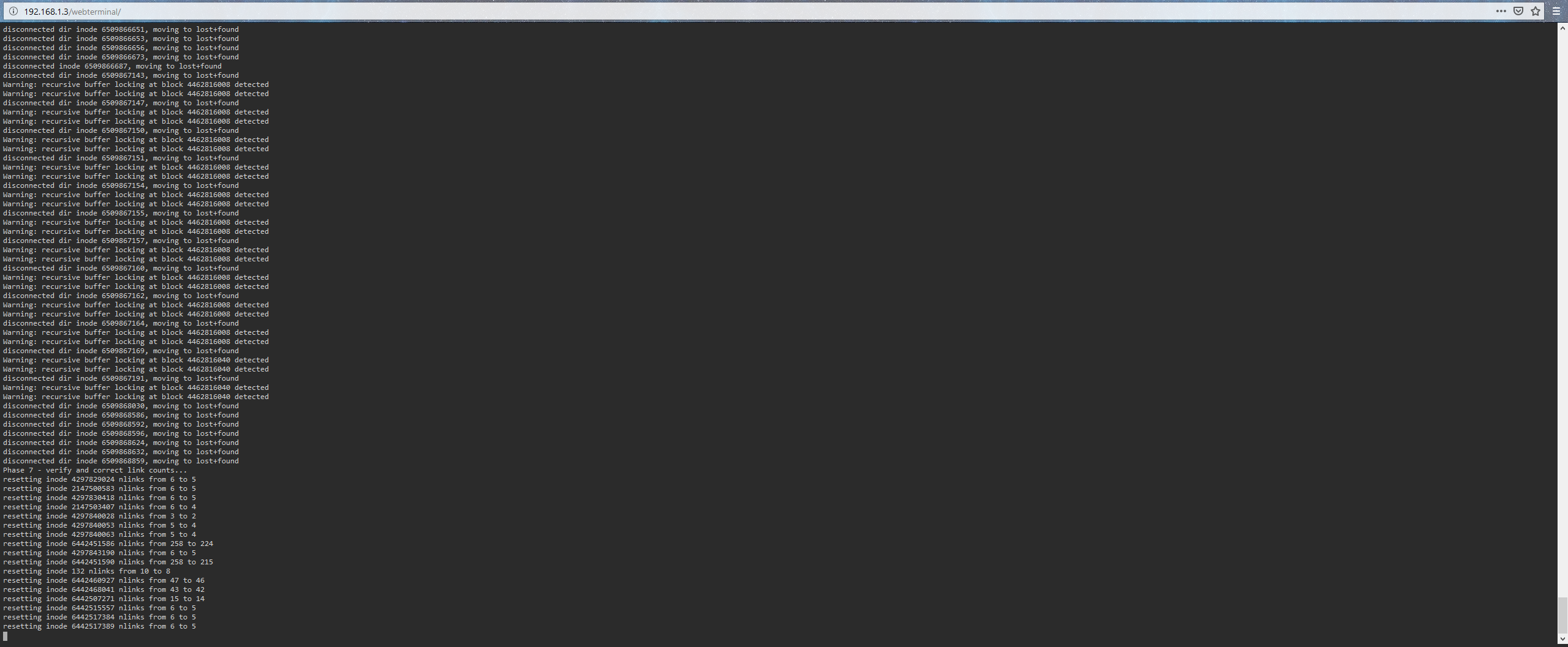

I let this run for several hours on the repair and this is were it just stays at now     302535433_notrepairing.thumb.png.ff33dba2c0bae2e94626c18411ecceeb.png
