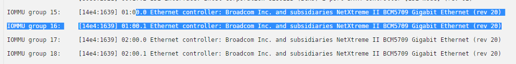

Image 2.png is normal IOMMU group settings.

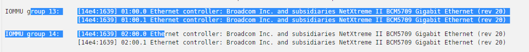

Image 1.png is I set VM manger > PCIe ACs override to both.

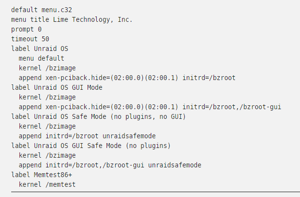

If I add 14e4:1639 to the flash boot wont it ignore my NIC card? Append vfio-pci.ids=14e4:1639 initrd=/bzroot

Trying using this but no go.
I added this and still no go.

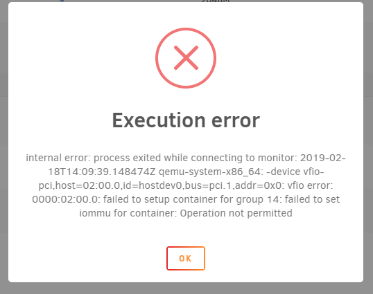

Here is the error message
You're not providing enough information. Need to post diagnostics (tools>diagnostics) after you get the error.
Here is VM logs.
2019-02-18T14:22:44.790281Z qemu-system-x86_64: -device vfio-pci,host=02:00.0,id=hostdev0,bus=pci.1,addr=0x0: vfio error: 0000:02:00.0: failed to setup container for group 14: failed to set iommu for container: Operation not permitted

found your problem in the logs, or at least, the next step in your problem:
Feb 18 08:09:39 Ruby kernel: vfio_iommu_type1_attach_group: No interrupt remapping support.  Use the module param "allow_unsafe_interrupts" to enable VFIO IOMMU support on this platform
go to the first post in the thread below and modify your syslinux.cfg to what it says in regards to unsafe interrupts, reboot, and try again. If it fails again, post a fresh set of diagnostics immediately after the vm fails. I can tell you from personal experience that "allowing unsafe interrupts" has caused me zero issues.
