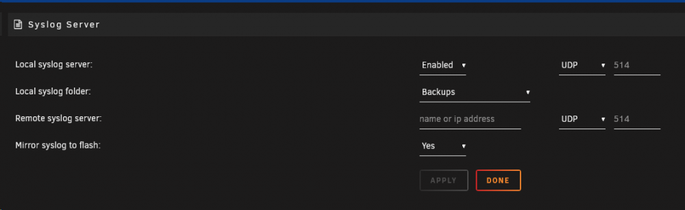

Are you wanting to do something different than the Syslog Server functionality now included in the latest unRAID 6.7.0 rc?
I wanted to be able to log from remote equipment (router) as well as unRAID server. Maybe I’m just not understanding how to do that in 6.7?
Go to Settings -> Syslog Server, enable the Local Syslog Server and set a port and a folder to store the data in.  Then give your router the IP of Unraid and port you specified.
Go to Tools -> System Log and there is a new dropdown where you can specify which log file you want to look at.  Or you can access the files directly in the folder you specified.
I set that up, but it doesn’t have a log file for my unRAID server. Maybe I just haven’t waited long enough?
Unraid's log is still in /var/log/syslog .  If you also want it in the new log folder you can set Unraid up as it's own remote syslog server.  Just put your Unraid IP in the "Remote syslog server" area.
3 minutes ago, strike said:
Exactly what I missed. Thanks.

How can I set a cache drive folder as the syslog server folder? I just get options for the shares. Don't want to keep array disks spinning...
Create a cache-only share for the logs.
