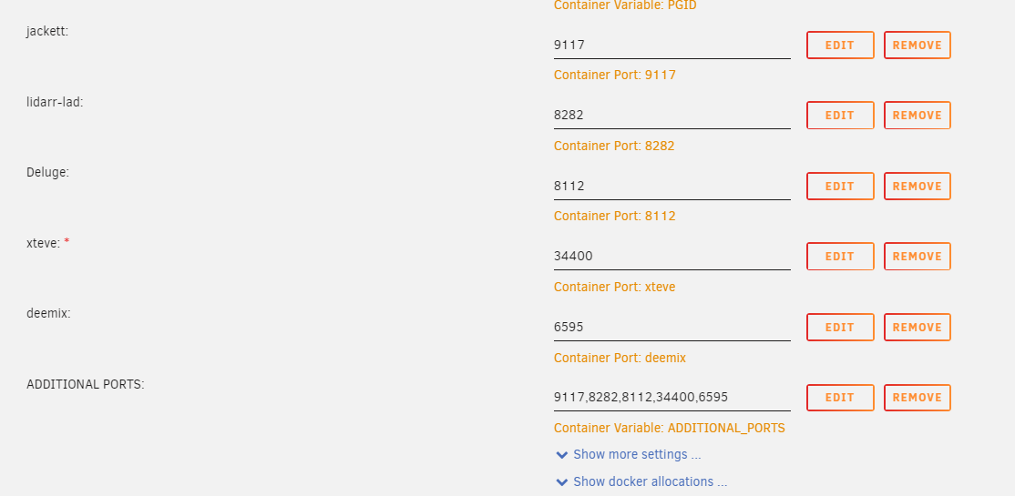

IMPORTANT:- As part of the tightening up if you run multiple containers through a single vpn container then please ensure you define all web ui ports (if more than 1 port then use comma to separate) for all routed containers in 'ADDITIONAL_PORTS' env var for the vpn container.
Hi, thanks for the update but I cannot find anywhere that says ADDITIONAL_PORTS ?  This is how I have things setup currently.

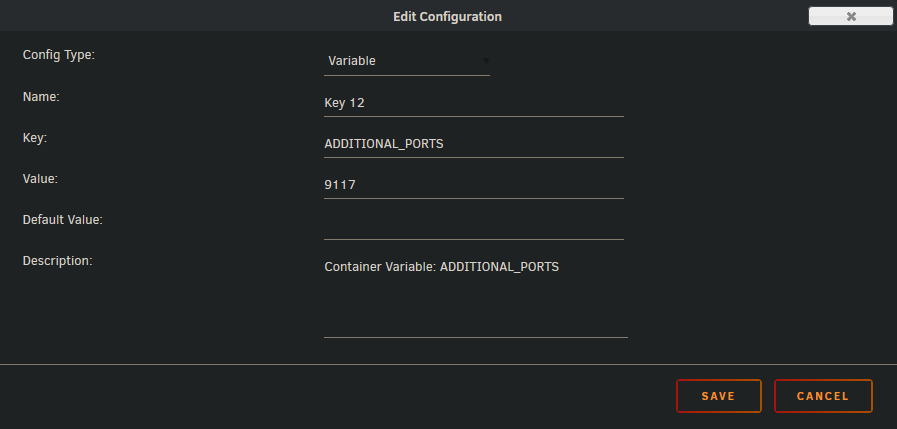

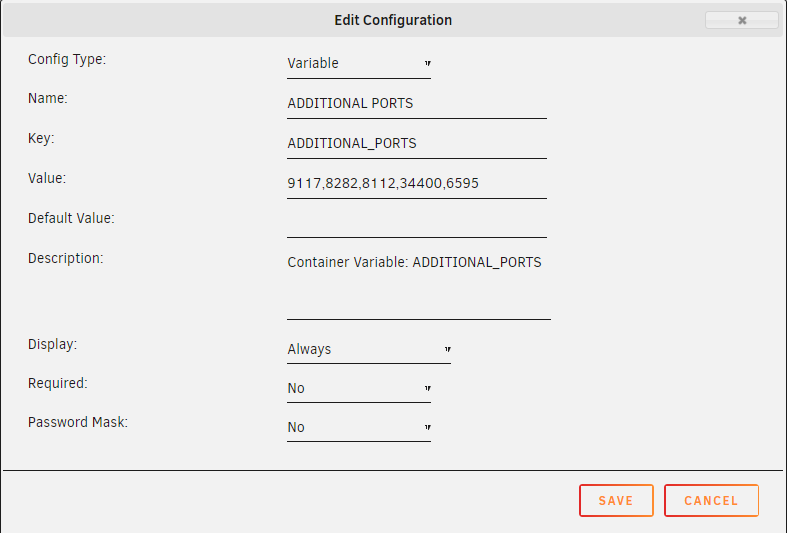

looks like your template is out of date, sadly changes to the template do not automatically get pushed out, so you will need to add in the env var, give it a key name of 'ADDITIONAL_PORTS' and value of the ports you want accessible.
How do we do this ?

How do we do this ?
The template is updated for me, but if it still isn't for you, you click on "Add another path, variable, etc" at the bottom of the docker page. Select variable, the name you want the variable to have on the docker page, the key, and the ports. I just use it for Jackett so I think the one port is done correctly.

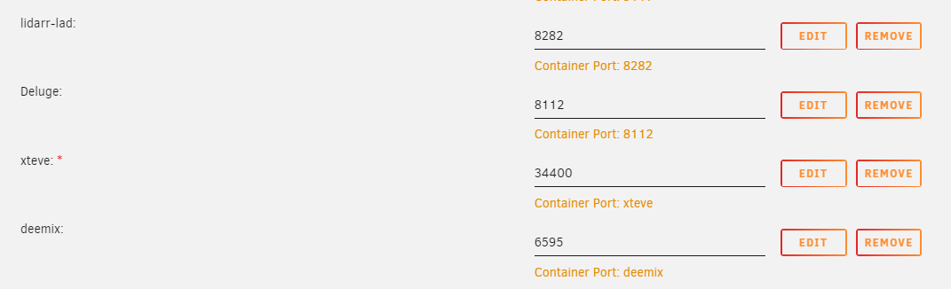

Should the Additional Ports Variable be instead of the settings below or as well as? my emby docker can no longer communicate with xteve and I am wondering if this is why?
Thank you
as well as
Don't know how I have messed this up but I cannot access any of my dockers passing through privoxy since adding the ADDITIONAL_PORTS Variable?
Thanks  @binhex I have read that and as I understand it I must make sure the web/ui ports are in the additional_ports variable which they are.
Jackett - 9117
Deemix - 6595
Deluge - 8112
the only other explanation was the localhost but I am not connecting to the dockers from within the privoxy network so that doesn't apply.
I was able to connect before so it is due to the new ADDITIONAL_PORT variable, if I remove it I can access them again.
that makes no sense to me, creating that variable means that additional allow iptable rules are created, very bizare!. are you sure you dont have any proxy settings in place here?, if so remove them.
