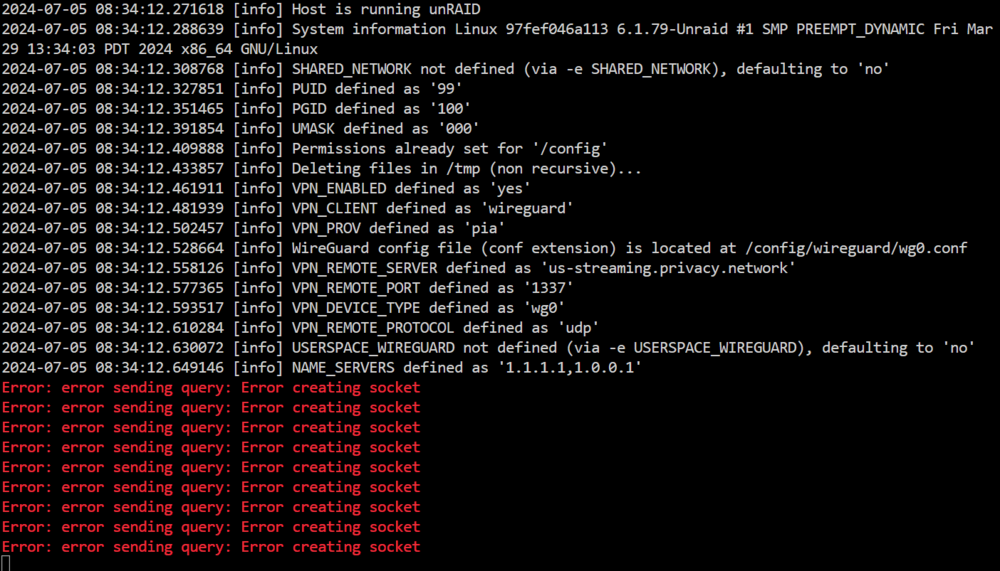

For anyone struggling to get PIA & Wireguard working together with this container (as I was),
Edit: Try changing the default PIA Wireguard server from Amsterdam to something closer.  Firing up speedtest.net showed a ping response of 175ms.  That caused most of the sites I was trying to reach to timeout and fail.  I'm not sure if there is a cleaner way to do it but I ended up editing the wg0.conf file manually and replacing the amsterdam server with one closer to me.  Seems to be working a lot better now.
Edited by dalben
Resolved the issue without needing other scripts
For anyone struggling to get PIA & Wireguard working together with this container (as I was), I used @Dor's PIA Wireguard conf file maker found HERE, copied the files into the Privoxy Wiregaurd config directory and it all worked straight away.
I appreciate the effort I'm posting this but it should not be necessary as I automatically generate the PIA wireguard configuration file dynamically for you, can you please detail what exactly you struggled with, as it should be very simple
You simply set the VPN_CLIENT value to wireguard insuring you have username and password defined and that's it, it should generate the configuration file for you
Sent from my CLT-L09 using Tapatalk

No errors but I couldn't reach any website when wet to PIA and Wireguard.  Flip it over to OpenVPN and it worked fine.  This was after a couple of re-installs.
I've edited my post.
I wiped the container and config directory then reinstalled everything again.  Same thing.  All the sites I needed to reach were just timing out.  I then compared the new config with the working one I had.  Only difference was the wireguard server being used.  I replaced the default amsterdam with one closer to me and things started working again.  Pings on speedtest.net went from 175ms to 4ms.  Websites are reachable.
Edited by dalben
If the only change you made in order for it to work was to switch the server then I would assume you're seeing geoip blocking or VPN provider IP range blocking for the Netherlands
