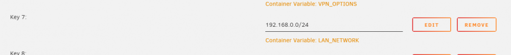

Hi there... I managed to get binhex-privoxyvpn container to work on my unraid setup. I have 6 media download containers that i use with privoxyvpn. I also have several other containers running on the same machine that dont go through the privoxyvpn container.
When I am inside my network, I can reach all the containers web pages without a problem.
When I am outside of my network, I use wireguard from my phone and connecting to wireguard on my unraid machine. This works great for ALL containers that are NOT using privoxyvpn.
Is there a way for me to reach those other containers that are being protected from privoxyvpn? I thought the whole point of wireguard was to give me access to my network as if I was inside my network, but this is failing for these 6 containers only.
The only thing I can think of is reaching an internal machine via the RDP client and then from that internal machine opening up a chrome browser to then hit those 6 containers protected by privoxyvpn... but this is pretty convoluted and from a phone, pretty ridiculous. Hoping to avoid the whole RDP thing if possible and just open up chrome/edge/safari on my phone and reach those 6 containers while connected to wireguard...
Edited by bullmoose20
spelling errors and further clarification

Add your network range for wireguard to the LAN_NETWORK, use a comma to separate values
Sent from my CLT-L09 using Tapatalk
i also went to your VPN FAQ link and thought that #2 "mangle" option was needed and tried that first but it did not work. trying the LAN_NETWORK option now
worked! as suggested... LAN_NETWORK was the solution
yay :-), another happy customer.
