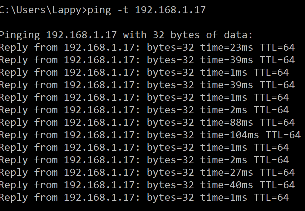

Yea, from what I understand, this is caused by the way Plex does audio/video sync.  Due to the wonky wireless drivers the nVidia Shield TV has, it gets out of sync and throws the error.  When I heard about this, I did a test:  I pinged the Shield TV from a laptop on the same wireless AP and, no joke, the response time varied WILDLY...everything from 2 or 3ms all the way up to over a hundred!  It's all OVER the place!!
So, I'm just going to try cabling it and see if that fixes it.  It should, in theory.

I don't think the issue I'm having has to do with filetype or compression or anything as I have the issue with all different kinds of files.  Including mkv.  I think having it cabled is what makes the biggest difference.
So, I ran a cable to it and it hasn't done it since.  Cabling it seems to fix the issue.
