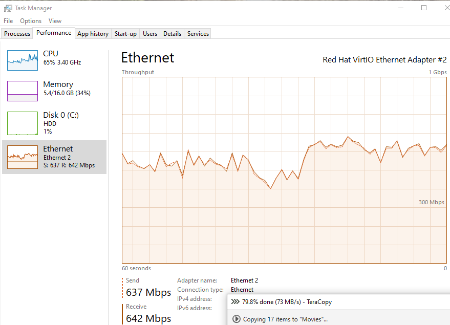

When copying files from one share to another share via an intermediate Windows10 VM is the virtual network connection a limiting factor?
I get max 500-600mbps (about 50-75MB/s) when copying large files.
Is the limit the HDDs or the virtual network?
If you use windows explorer (or robocopy) files will be copied locally, they won't use the network, using Samba's server side copy.
