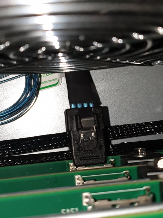

I've not been inside my server for a while and it uses sas to connect to the HDDs.
I got mixed up with the cables as I needed a breakout cable last time to connect the motherboard sata connectors to the HDDs.
So because the Dell card uses Mini sas and also the front of my server connects using sas. I've ordered the wrong cables which I will need to return.
The image is the connector that goes to one of the bays on my server for the HDDs.
Am I correct in that this connector is mini sas?
And I would need a mini sas to mini sas cable. And it does not have to be forward cable?
