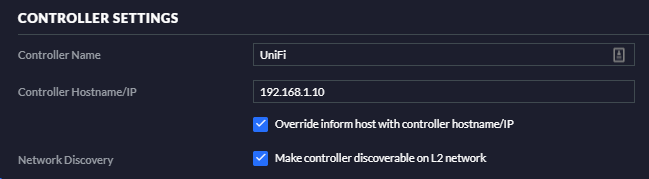

Changing to host mode is one thing some users needed to do (me included on to get devices recognized - then I set it back to bridge after adoption).  You will likely also need to set the Controller Hostname/IP to your unRAID server IP and Override the inform host.

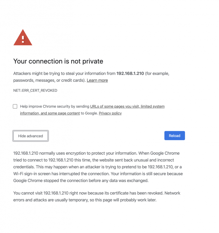

Trying to setup unifi controller and try load the UI and I am getting the following error:
1431213753_ScreenShot2019-12-29at12_23_34PM.thumb.png.c19a0321b3a1c4db0bbcd1823d1ca107.png
How long did you wait after you started the container?
It generates the ssl certificate on first run, so might be you didn't wait until the certificate was created.
This is a chrome issue not liking the self signed cert that the container generates. Unfortunately I'm not a chrome user so no sure what the fix is. I know there was a user that had the same issue earlier in this thread.
I just now set up this Docker container and accessed it via Chrome Version 79.0.3945.88 on a Mac -- no issues with the self-signed cert.

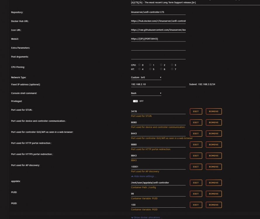

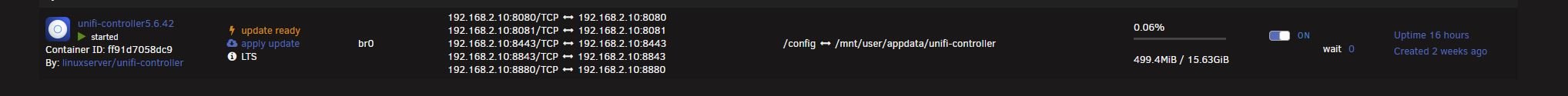

Hello,
  I have a weird docker-ism where my docker always shows that I'm in need of an update. The docker install is on 5.6.42. I can pull the update, but on next check, it will always say I need to pull a new version. Weird. It's not a big deal, but I've attached my docker settings and the "header" on the docker summary page.
  Thanks guys--if you have a free minute or know what causes this, I'd appreciate the insight!
Josh
PS: I have a similar cert issue that dorgan's having, except I can manually override the Chrome objections and go to the site. Not sure how to get a properly signed cert from the IP address I have the docker on like I do with the main unRaid server site.
Edited by uiuc_josh
Forgetfulness. And age.
10 minutes ago, uiuc_josh said:
Hello,
Josh
What version of unRaid
