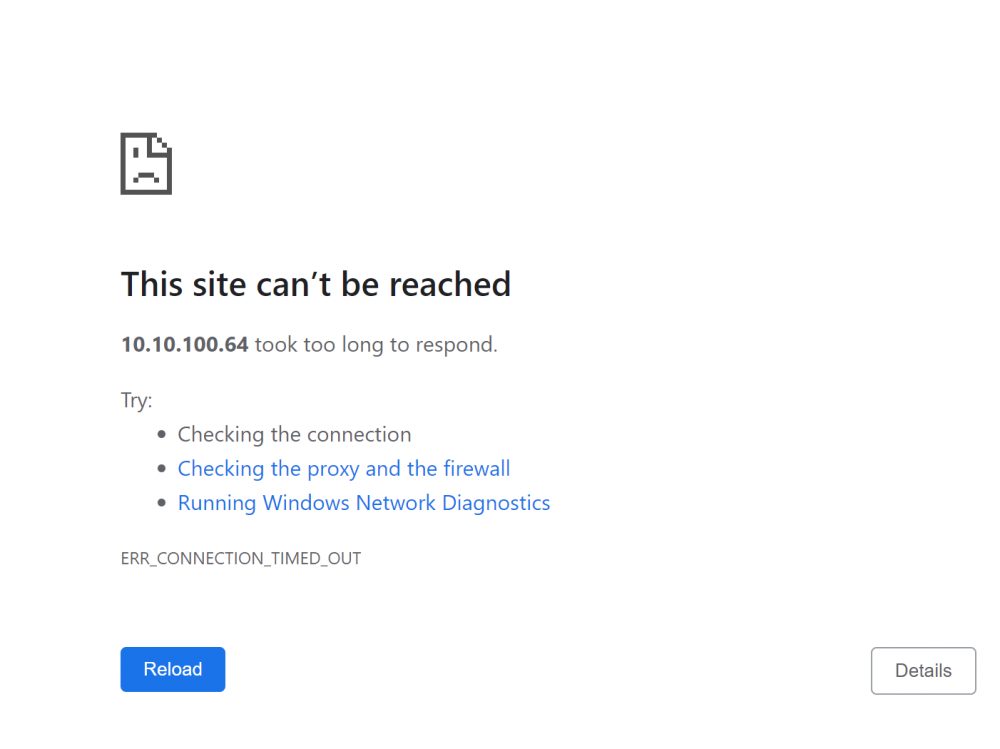

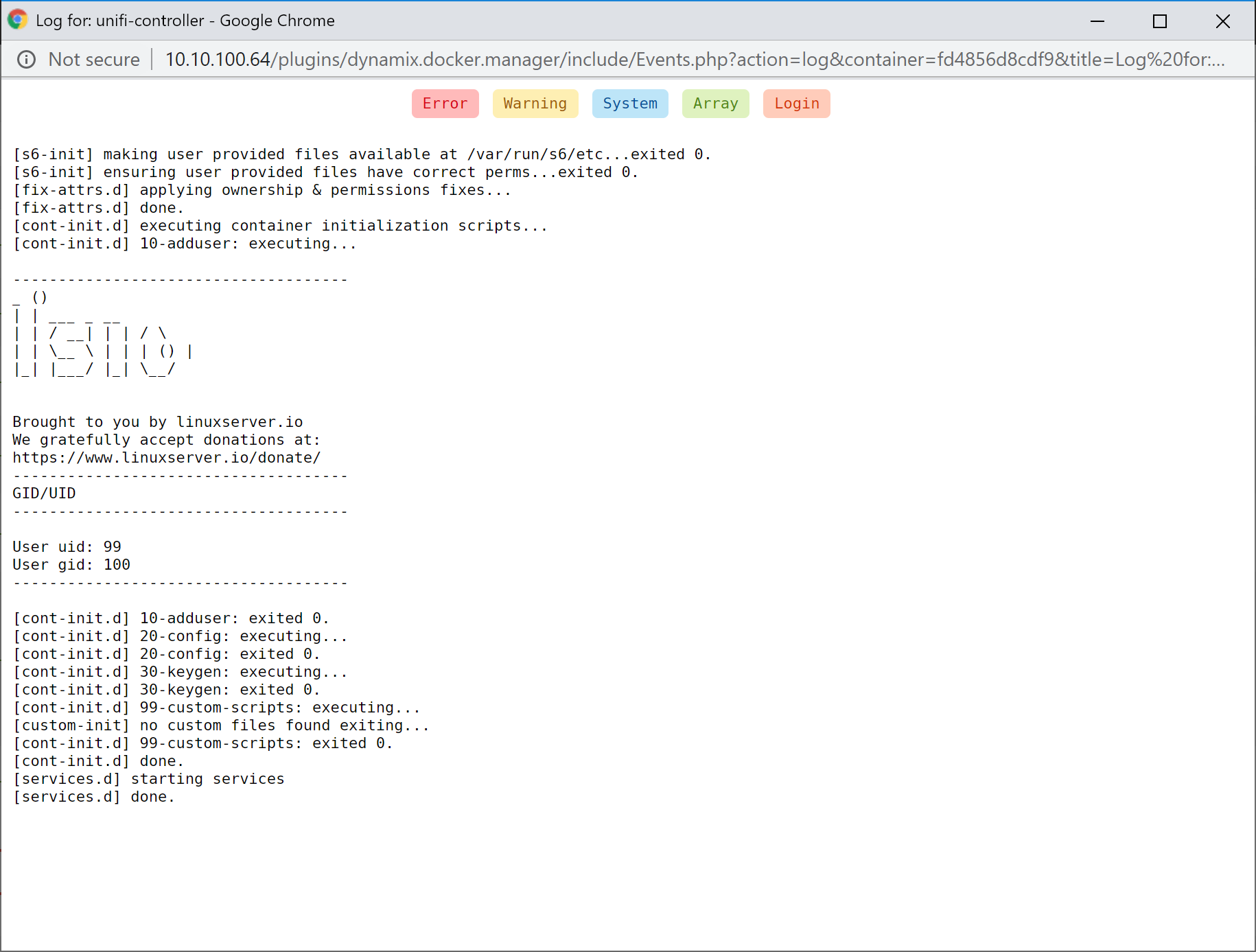

I have removed and downloaded the latest docker again from CA.
But still unable to load the web gui. Any ideas where to start looking now? Thanks.
See screenshots below.

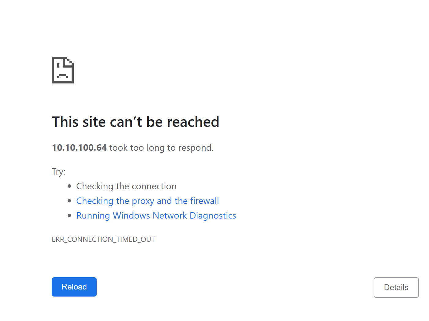

Which port are you connecting to?

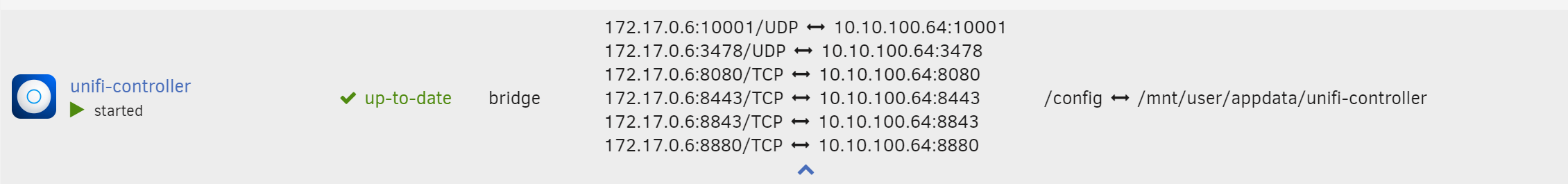

Default config points to https://10.10.100.64:8443/
Try changing the appdata path to /mnt/cache/ instead of /mnt/user/.
Finally got it going. I didnot have to change any config.
I guess there was something not working in the background and finally everything clicked.
I have migrated my controller config from VM to the docker, and the devices have migrated and integrated with the new controller docker.
Thanks.
Have had the controller up and running from years. For some reason no able to access the webui today.  Logs were no help but changed from mnt/user to mnt/cache and have access again which is great.  Was there some change to the container that caused this?
Brought to you by linuxserver.io
We gratefully accept donations at:
https://www.linuxserver.io/donate/
GID/UID
User uid: 99
User gid: 100
[cont-init.d] 10-adduser: exited 0.
[cont-init.d] 20-config: executing...
[cont-init.d] 20-config: exited 0.
[cont-init.d] 30-keygen: executing...
[cont-init.d] 30-keygen: exited 0.
[cont-init.d] 99-custom-scripts: executing...
[custom-init] no custom files found exiting...
[cont-init.d] 99-custom-scripts: exited 0.
[cont-init.d] done.

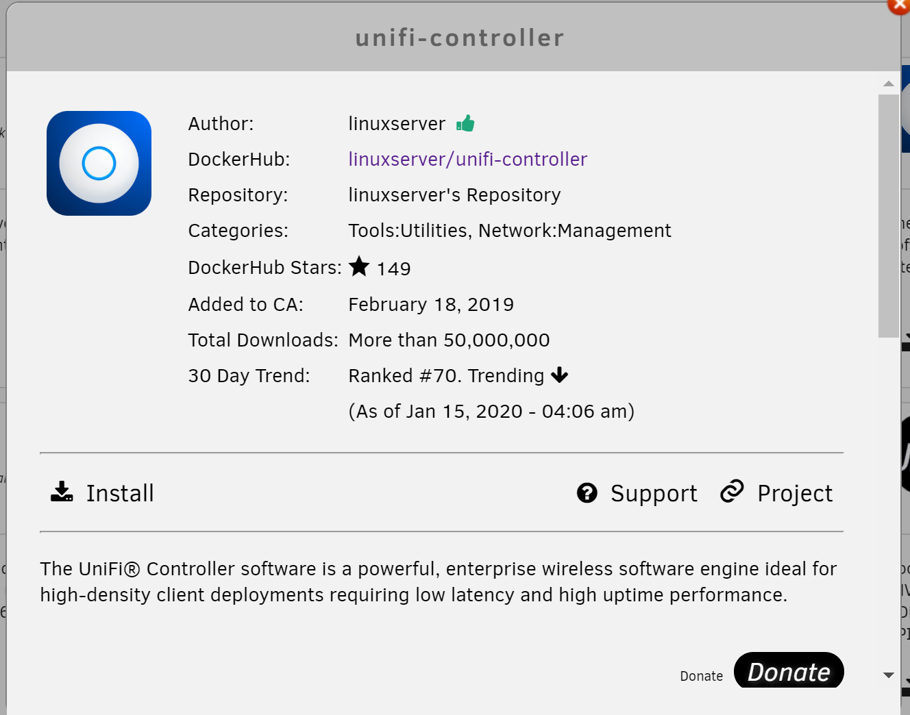

It has been a long time, but how do I get the new container again?
Never mind, I found it in the APPs tab.
