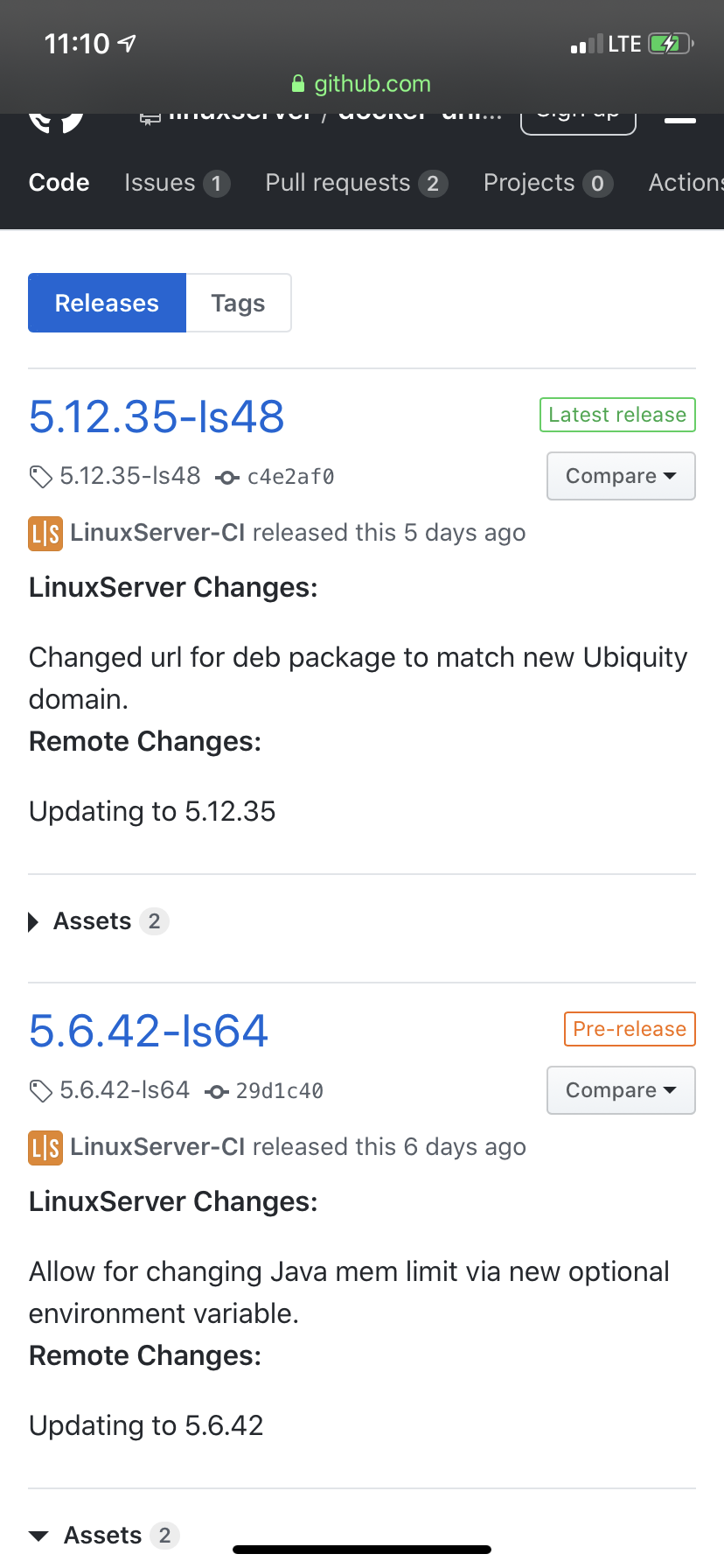

The release notes on the github page show that the url that the container pulls the app from was changed to accommodate a change made by Ubiquiti. Just clicking the update button should work. I didn’t have any trouble updating.
but if you look to the prior releases in the -latest branch, it's the same comment/update for 5.12.35-ls49 (5 days ago) , 5.12.35-ls48 (12 days ago), 5.12.35-ls47 (18 days ago), 5.12.35-ls46 (26 days ago), etc.
So please correct me if I'm wrong, but it doesn't look like the updates are for something ubiquiti has changed.
I have to assume that only Ubiquiti would be able to make changes to their domain but I don’t know anything more than what’s in the release notes. Perhaps someone from @linuxserver.io can provide more detail?

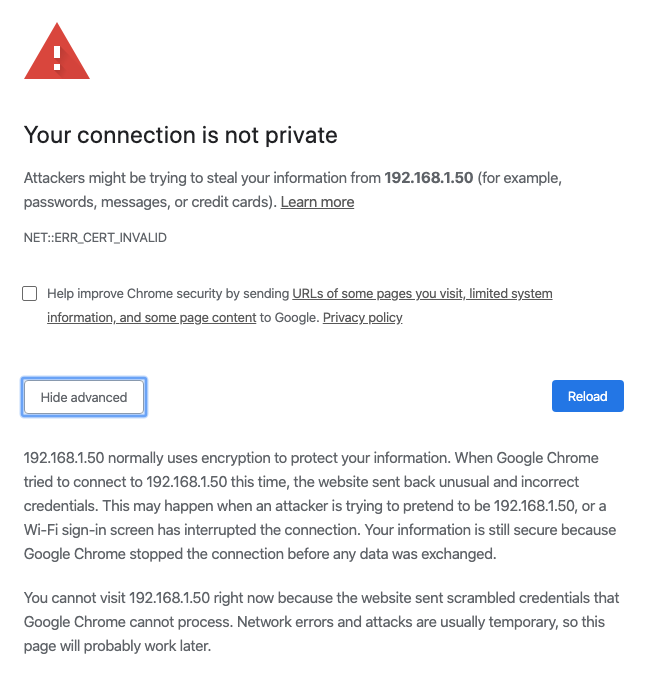

I've always got the SSL Cert Error when loading the Unifi Controller web UI and I would just click Advanced and Proceed Anyway.  However, Lately I'm getting a different error in Chrome and can't proceed.  Still loads fine in Safari and Firefox. Any ideas on how to fix?
No, but what shows up if you click on the text "NET::ERR_CERT_INVALID"?
Can you post the result here?
Reason I'm asking is I'm getting a different error that has the proceed anyway available, and I'm wondering what the difference is.

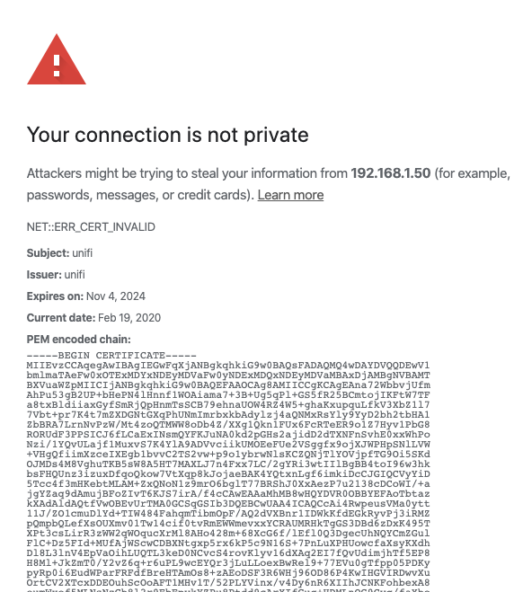

When I click on the error I'm seeing, here is the partial result.
Subject: unfi
Issuer: unfi
Expires on: Jan 21, 2021
Current date: Feb 18, 2020
PEM encoded chain:-----BEGIN CERTIFICATE-----
I found a link on how to import a self signed cert, but I don't think it's going to work in your case. Could be wrong though.
https://www.pico.net/kb/how-do-you-get-chrome-to-accept-a-self-signed-certificate

I used to get the proceed anyway option but something changed a few weeks ago.
Did you try the link to manually add the certificate?
