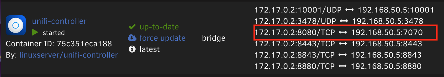

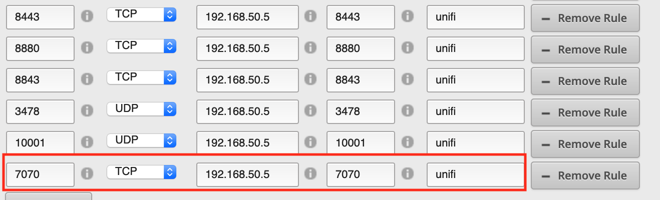

So I have port 8080 used by other docker and had to change default when setting unifi docker.
I have changed ports in docker as follows:
and then I have forwarded the following ports in edgerouter:
I have highlighted change from 8080 to 7070, as this is essentially the only change from default ports I have made. Can someone check if the above is correct?

EDIT: it worked perfectly with exactly the settings as above, first I exported sites and imported into new docker container. The local aps moved at the same time as a part of this process.
Then I was lucky as on the remote sites I had also team viewer connection, I shhd into one of the ap and sent new set-inform command - withing a second it was adopting on the docker controller. I could send the inform command straight from the old controller but wans't sure if the above configuration is valid so wanted to be extra cautious and take one at a time. Anyway, all worked fine. At the end of the process I deleted all sites and removed them from unifi cloud account. Running since then on docker without any issues.
