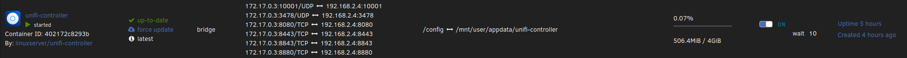

Hmm I am not experiencing these issues with 5.13, here is a screenshot to show no memory increase:

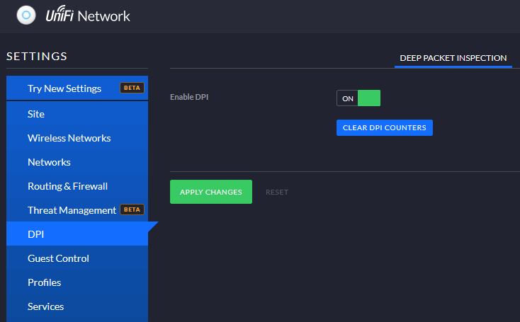

I have also turned off the deep packet inspection (beta) to see if that's the cause. It's still growing but would be at 1.3GB after 24 hours so we'll see how we go.

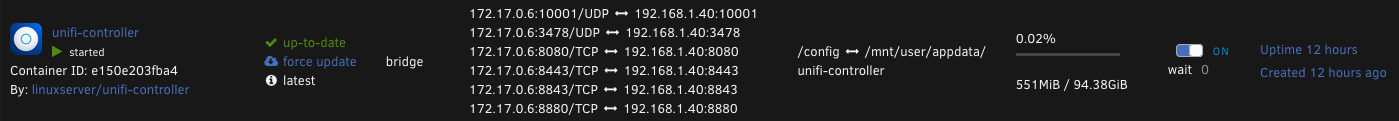

551Mb after 12 hours pfsense router
2007593375_ScreenShot2020-06-17at3_13_46PM.png.254ebb91b835d310a2686f1725327639.png1302196106_ScreenShot2020-06-17at3_13_11PM.thumb.png.f08b0aee4eec0256df0f7718f00cc6f8.png
Edited by soana
added info

Thats strange that I dont have mine growing. I dont have a unifi gateway so maybe the people where it grows all have gateways and use things like dpi etc like you ?

I don't remember turning on DPI but I must have done, and being a Beta feature I wouldn't be surprised if this was having issues.
Anyone know when DPI was added to unifi? Was it after 5.11?
DPI is on for my USG and has been for quite a while.  It does not show as beta for me.  It has been in the UI for longer than just 5.11.  I am going to turn it off and restart the docker container to see if that has any impact of growing memory utilization.  However, I only noticed the memory leaks beginning with 5.11 and DPI was on before that.
