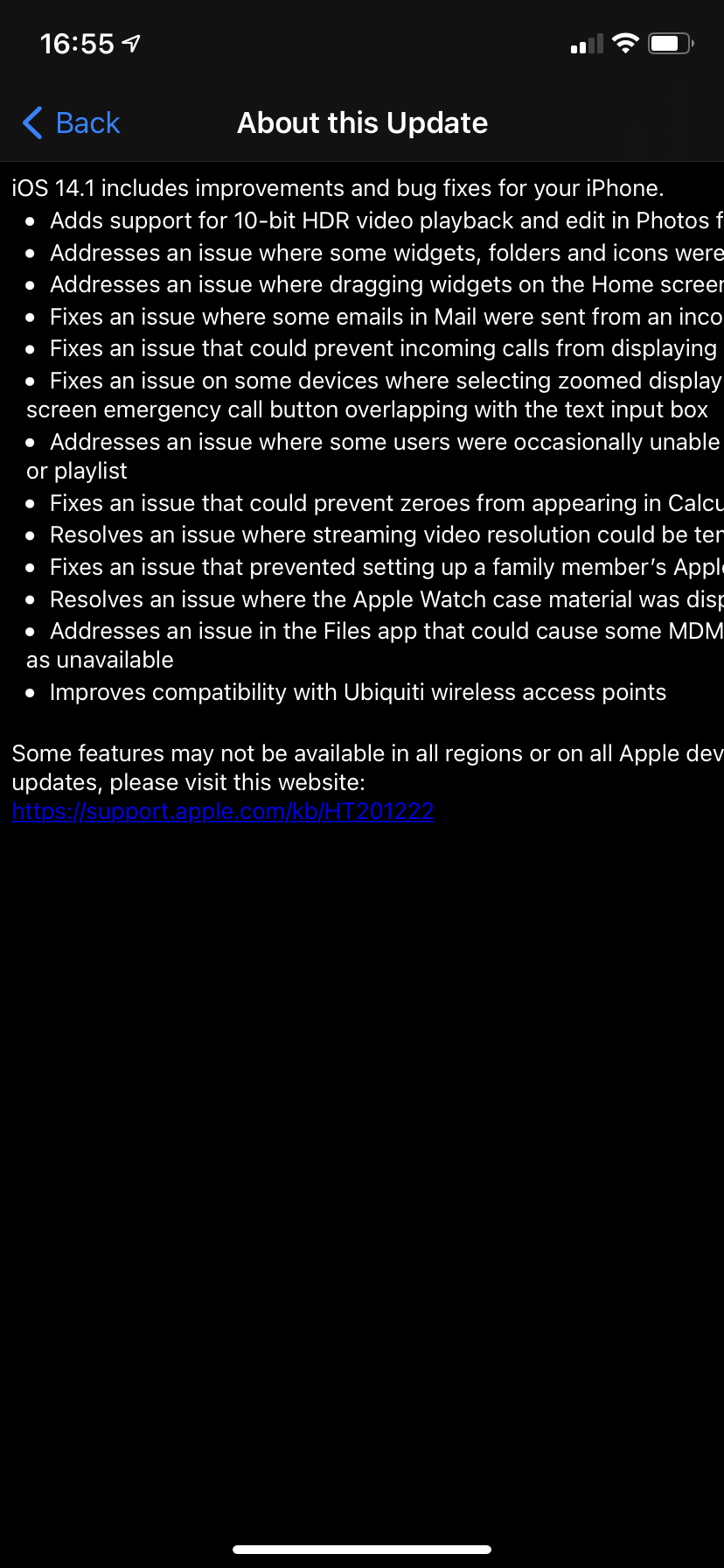

Here is an interesting thing to note from latest IOS update. I may think about updating soon as a result (see bottom message). Will review further tomorrow and post findings.

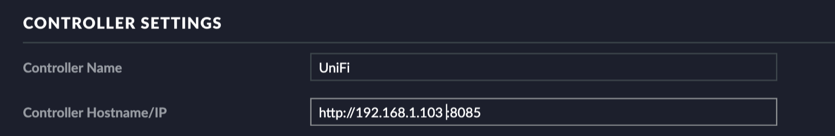

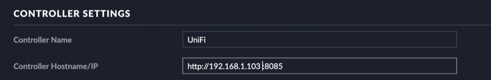

I just noticed there is a space between IP and colon ":" Will this explain why it doesn't reconnect when disconnected?  But I believe this doesn't explain why AP keeps on disconnecting from controller.  Will read on it this weekend, how to create local DNS.  Will also change ports 8080.
Not too sure if that is valid even without a space. You can only put an IP address on its own (that is how I have always used it ) or a FQDN. As @jzawacki mentioned above, the docker has no method to support changing the port so any attempt to change the port to a non default one will not work. The docker has to run on the default port, regardless of if that is convenient for you or not.
