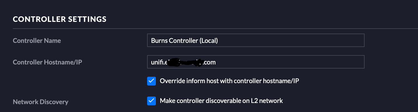

Im hoping to revisit something earlier in the thread. I have some devices offsite for family members that are pointing to my FQDN for set-inform. My controller is running in docker with a custom bridge as the network. I can set the controller hostname override to my FQDN and get everything to provision except my USG onsite here. If I set it to my local IP then the USG provisions but I lose the offsite devices. Anyone have a fix for this?127674016_ScreenShot2020-10-26at9_36_29PM.thumb.png.985d8cba8f111490031206a62cb5575b.png
Enable nat loopback, hairpinning, reflection or whatever your router calls it. Nothing you do to this container or unraid will fix it, you must get your router to cooperate.
On 10/27/2020 at 12:38 AM, Elembemedia said:
Hey everyone,
In this setup it can also be resolved by ensuring you have a local DNS server with the A record for unifi.exxx.xxx.com set to the internal address of the USG, while external DNS servers will continue to resolve that DNS address to the public IP of the USG. This is known as split DNS and can be used to resolve this kind of problem. The USG dns should be set to the internal locally controlled DNS server in this setup type.
eg: internal DNS server could be pihole.
in pihole add local dns record for controller - eg: 192.168.0.2
ensure dns on usg is set to pihole and it can see pihole server locally so it can resolve hostnames.
internally unifi.exxx.xxx.com will return ip of what is set on pihole server for the controller (eg: 192.168.0.2 if unifi controller was .0.2 for example)
external clients who use external or other DNS servers will continue to receive public IP for unifi.exxx.xxx.com address.
Now both internal and external clients can see a different but correct result for this unifi.exxx.xxx.com address, result that is valid depending if on inside or outside of network.
