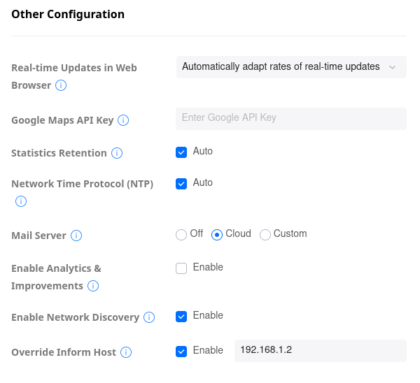

Am I doing something wrong, or just not understanding something? I have a new install of this container, but I can't get my phone to connect to it and therefore also cannot get my new G4 Doorbell connected. I'm able to login, go to System -> Other Configuration, and turn on both Enable Network Discovery and Override Inform Host. I put in my server IP address, but nothing seems to come of it. I had to change one port during the container install, but other than that, everything is vanilla.
When I have my phone Add New, it goes to Console discovery and then sometimes shows two options:
  • Cloud Key Gen2 Plus
  • Network Video Recorder
Am I doing something wrong? Do I have to purchase their hardware like a dream machine? Or can I just use this container and my unraid storage?
@slughappy1
This container is just for the UniFi Network Controller.
For hosting UniFi Protect, you need either the Cloud Key Gen2 Plus (this is what I use), UNVR or one of the UDM Pro models.

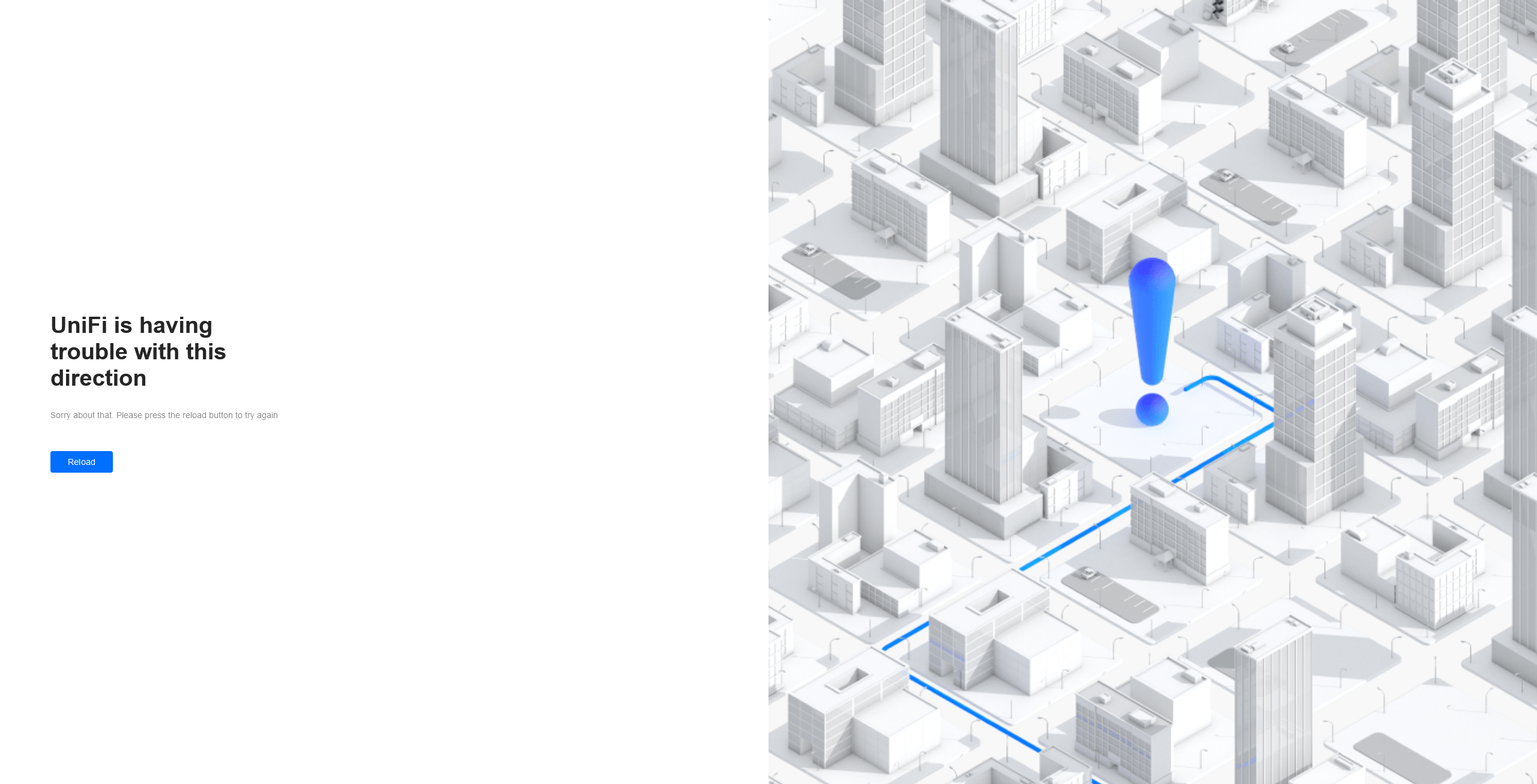

Hello!
Last two weeks all i see on uni-fi controller webpage is this. How can i fix this?
I didn't change nothing in nas. Docker plugin update didn't fix nothing.

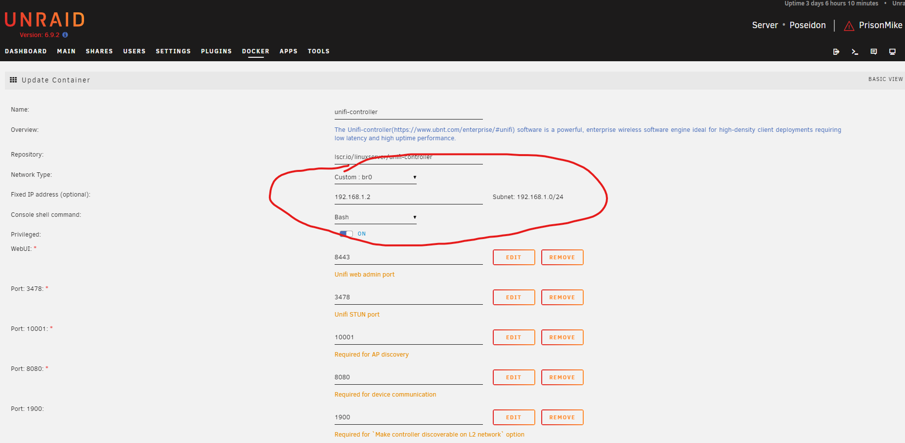

Hello, I had the same problem about a month ago. I just shut the docker container off and forgot about it until recently. When I fired up the docker again, I couldn't reach the web GUI for some reason. I deleted my app data and downloaded the container again just to be safe (twice). And I still cant reach the web GUI no matter what I do. This is very frustrating as I have been wanting to upgrade my APs. If anyone has an idea, please let me know. Thanks!
LOGS
Edited by PrisonMike

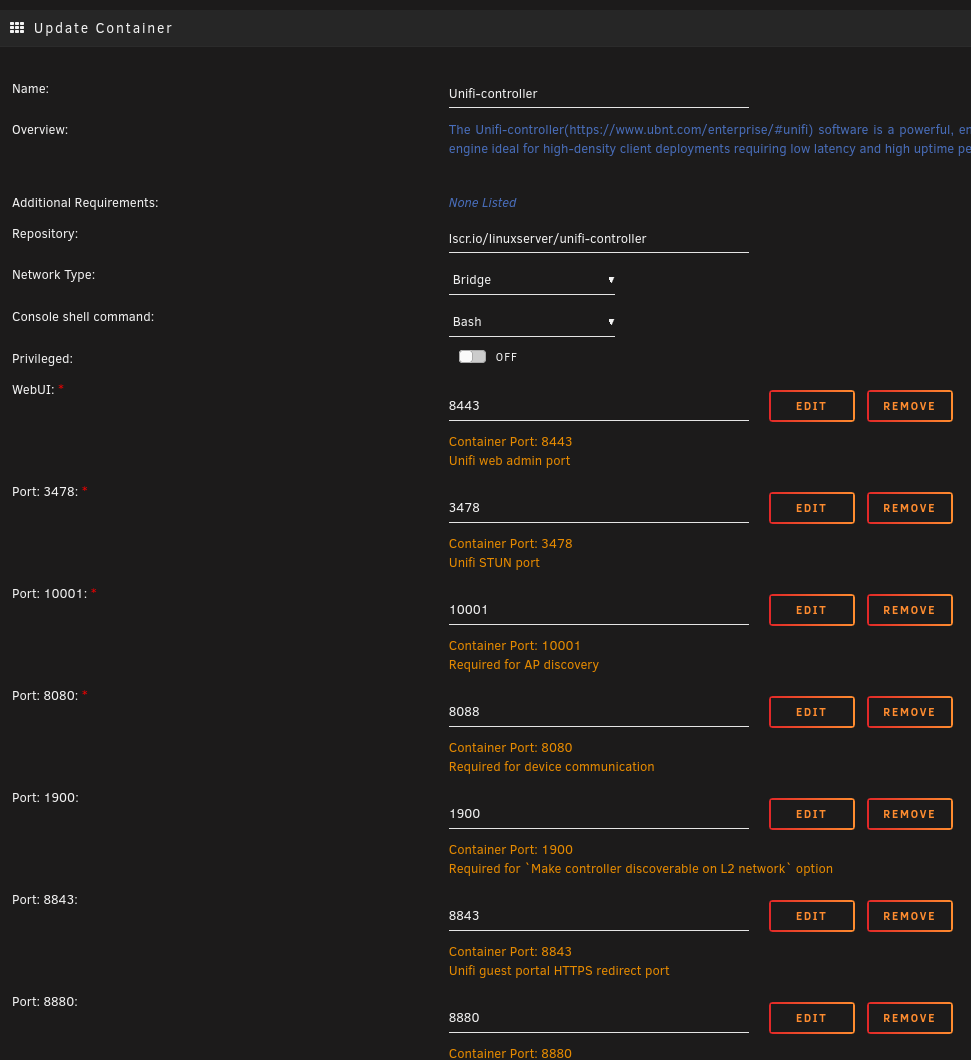

Any other docker running on the same ports?
Well yes, but actually no. My server is 192.168.1.5 and I have unifi docker running on 192.168.1.2 so that shouldn't matter right?

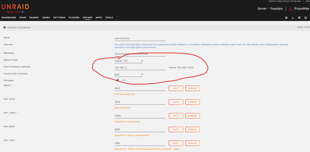

Select advanced view and upload a new screenshot please.
Here is an advanced view. Thanks for your help!

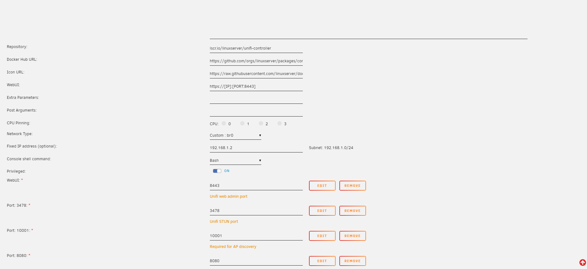

Try changing the WebUI to https://192.168.1.2:[PORT:8443]
