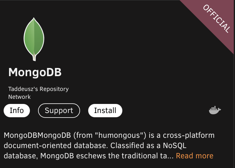

  4. Go to the CA tab and search for MongoDB. You will see the official docker available in the results. 1150319135_Screenshot2023-10-27at1_44_48PM.png.69a3cac0d1117cb953e414abcb7b8865.png
  5. Install it with the following configuration-

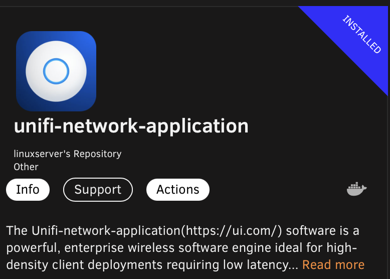

  6. Gon to the CA tab and search for LSIO's unifi-network-application docker. 1264307742_Screenshot2023-10-27at2_08_56PM.png.f71445a5db49651c69efd55f757c9ccc.png
  7. Install this docker with the following configuration:
