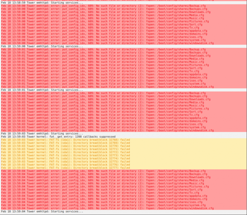

Randomly shows array offline and throws errors.
Version: 6.6.6
not even sure where to start, but I need some help get my unraid server back and running. Nothing was added or changed at the time of this happening.
Shows the array offline, but I cant still access dockers, vms, shares. Though it shows the gui back to white and all of the gui is out of place
tower-diagnostics-20190218-1359.zip
Edited by xxbryantd
Flash drive problem, could be corrupt, failing, or try using a different USB port, USB 2.0 preferred.
brand new ADATA 32gb usb. Though I think I have it in a 3.0 usb, so ill swap it and see if that help.
