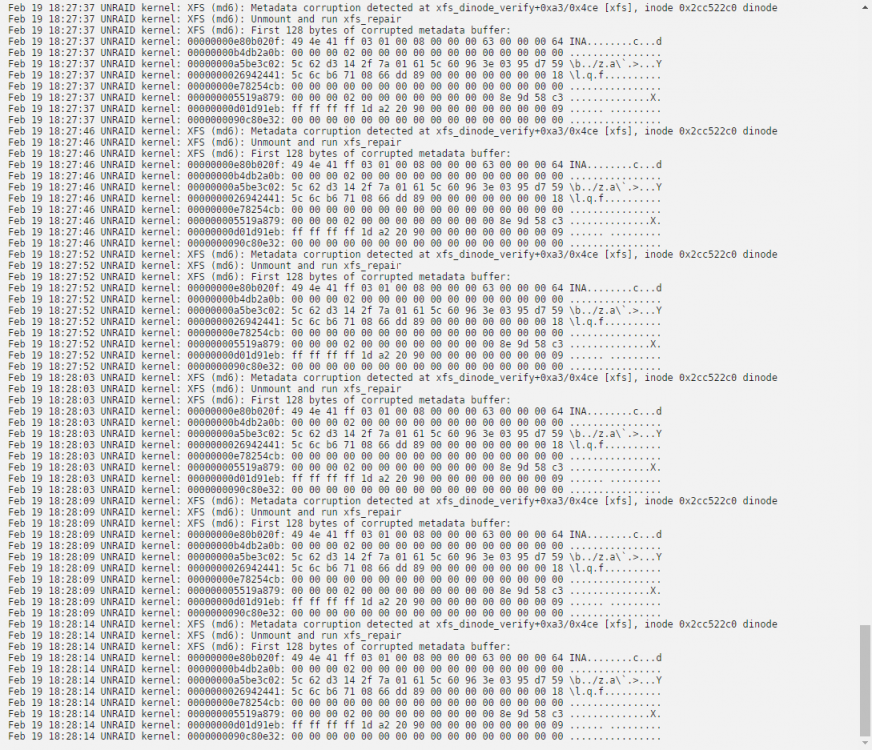

My machine locked up during a permission rebuild. Upon reboot, I see a ton of this:
Do I need to let it finish or should I cancel the parity check and run xfs_repair? If so how? Thanks for any tips!
You can run it now or after the check, though some shares might not work until you do.
