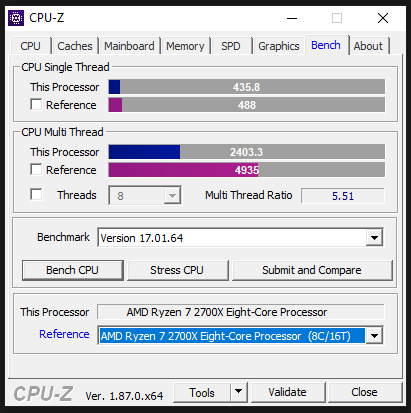

Performance for single core performance in cpuz bench  is about 40-50% less than the bare metal example.

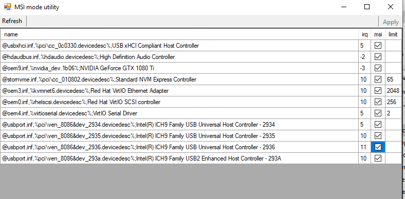

I just had a small lockup, opened task manager and saw "system interupts" at 42%
should i have all of these on?
Did you run msi fix on passed through devices?
I don't have any of those usbport devices checked on mine.

Here is the test for CPUz Bench... the multicore isn't that bad (i'm only using 5 of the 8 cores.
but the single core performance you can see is terrible compared to the referenced 2700x...

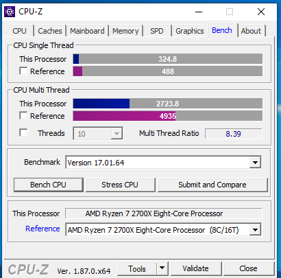

Then i closed ICUE - the corsair software that checks temps and probably other stuff to do with my gaming hardware (with millions of tx per second)
it's not perfect but it is a lot better.
I'm no longer able to use my gaming stuff properly but this definitely seems like a big improvement.

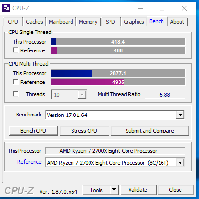

I corrected the topology and i get an extra boost as well, so thanks for that.

just an update..
Even if you close the ICUE app, it runs a service which was taking 2-5% cpu (of total cores). I also noticed in unraid my 1st CPU was always showing as 20% in use (in the main window).
Uninstalling ICUE makes it even better. I'm now only using 4 which is why the multi thread is low.
My WinVM seems a lot better. Smooth as anything.
