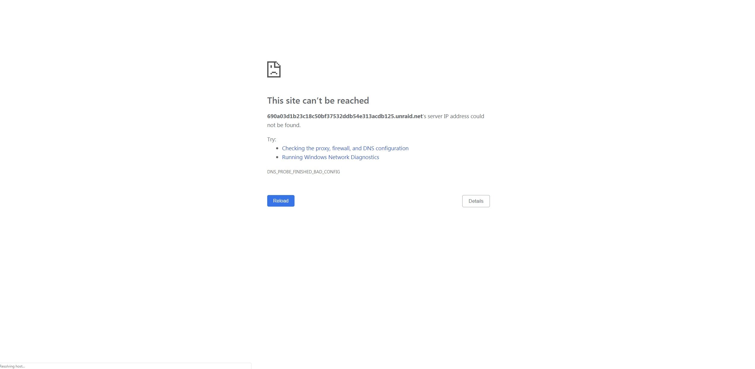

Hi, I was trying to update my plugins before upgrading and they didn't appear to be able to update. So I read that it could be because of advance buttons and deleted them from the flash drive under /config. After rebooting, I can't load the Unraid GUI. I CAN ping the server and access via telnet. I'm also using pihole on the server if that is affecting it at all? I've attached the diagnostics. Thanks for the help!

So I deleted the .plg file and still the same issue. When I try to access the GUI, it tries to "resolve host". I'm wondering if it has anything to do w/ pihole? I can't even access my router. I'm pretty sure I've rebooted my computer since installing pihole in the past though...

Ah sorry, bad wording. Previously, I also couldn't get into my router as well, but I restarted it and am able to get into my router. I still have the issue where I can't get into my server (same as first post picture). Thanks!
Is this still true? Have you tried both servername and IP address?
I tried both. I had to go into my router and change the DNS back to its original state instead of pihole. Not sure what the issue was, I followed space invader's tutorial. At least I know how to fix it in the future. Thank you for your advice!
