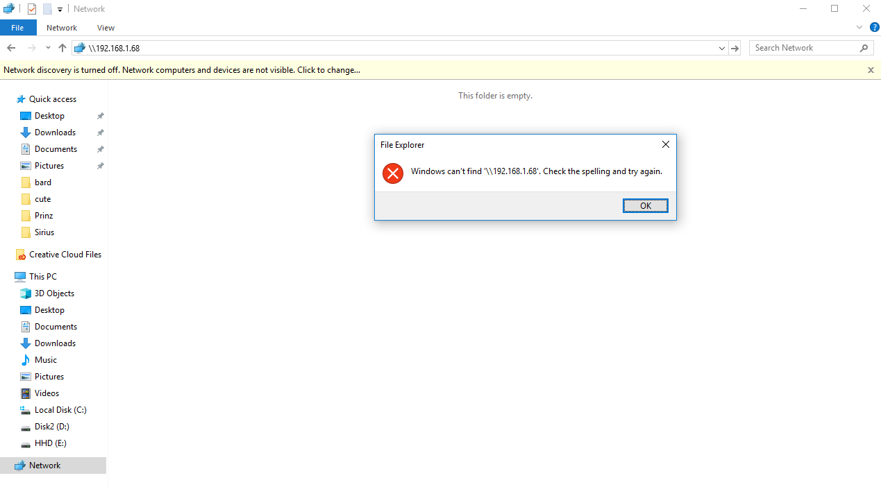

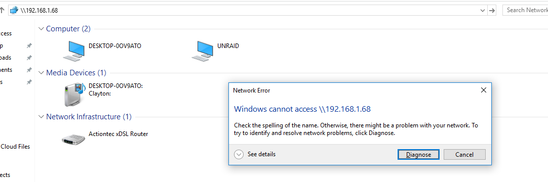

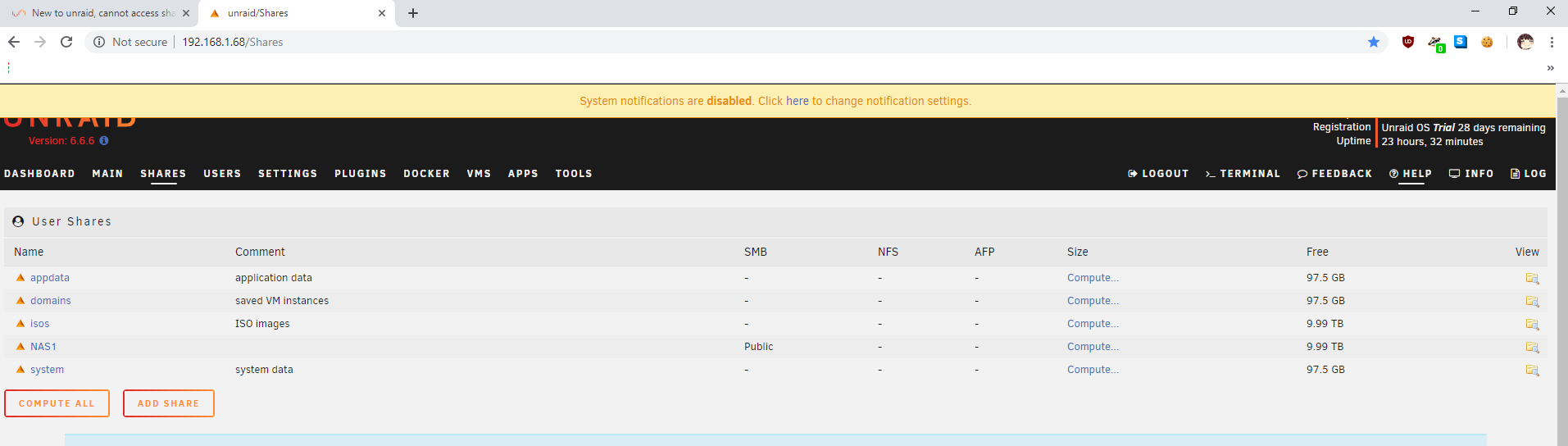

I was indeed typing it incorrectly however doing it the correct way (and in explorer) as you mention gives the same Network Error(both doing it with the \Nas and without.. Heres a quick screenshot just to help verify I'm not doing something silly. Also a screenshot of my shares.
Your screenshot shows the computer named UNRAID so apparently it does know the name. What happens if you double-click on it?
The same Network error that happens with the IP.

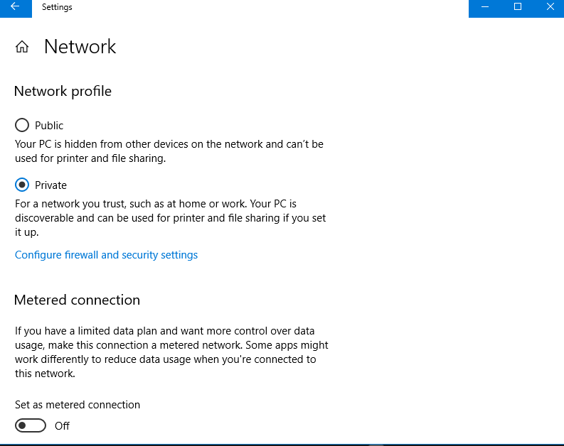

Is you Windows Network type set to be Public instead of Home / Work?
It's set to private, I tried to change it up public then I couldn't see the unraid machine anymore(I could still connect to the WebUI) when I did that.
