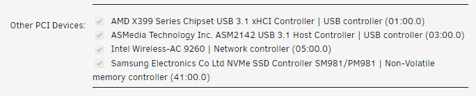

I have manage to get everything I want to work with my setup except on board audio passthrough.
Has anyone been able to do it?
ASC overide enabled.
Am I missing something?
append vfio-pci.ids=144d:a808,1022:43ba,1b21:2142,1022:1457,8086:2526 pcie_acs_override=multifunction isolcpus=3-15,19-31 initrd=/bzroot,/bzroot-gui

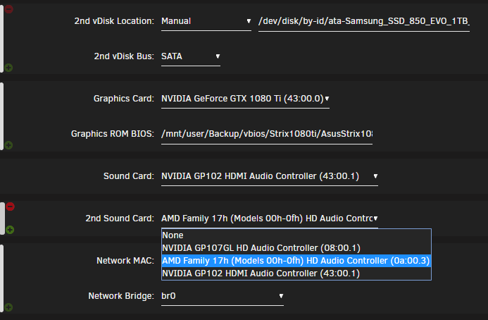

1022:1457,  IOMMU group 30:[1022:1457] , I believe is the on-board audio.
How about you select the audio device in the sound card section?
EDIT:
Without having it in the syslinux config.
