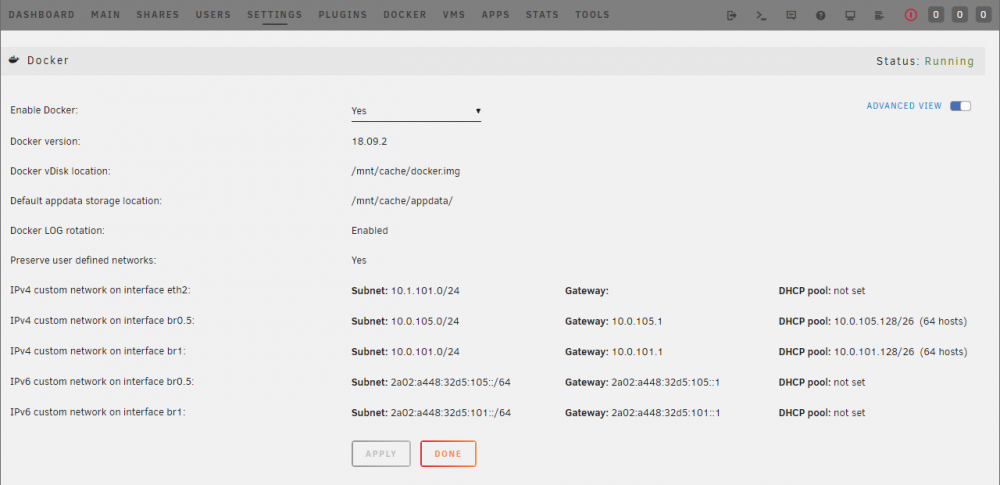

Networks are defined under Settings -> Docker
Or you can create your own user defined networks, make sure the setting "Preserve user defined networks = Yes"
