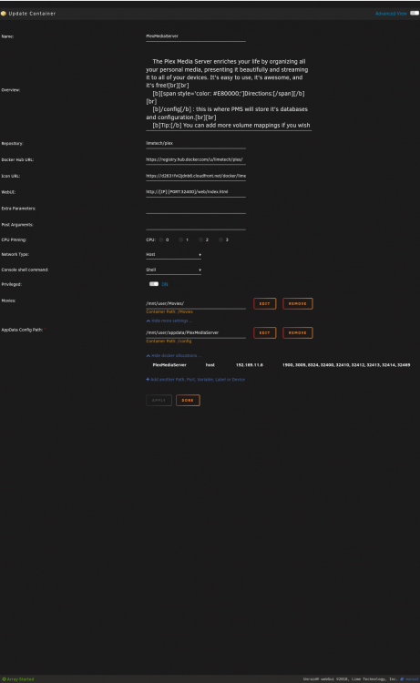

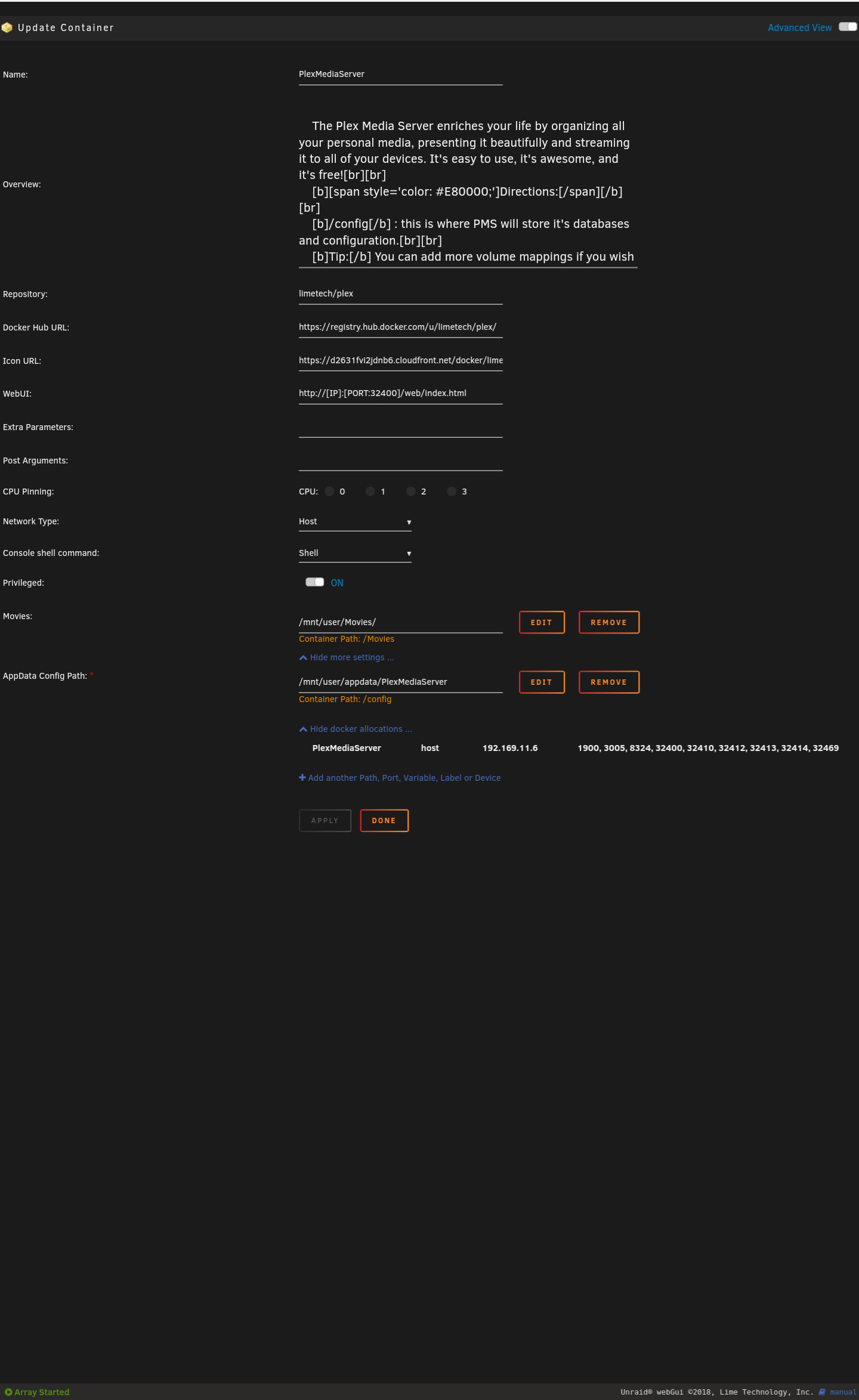

Any chance you could attach a screen shot of the docker tab and the Plex assignments.

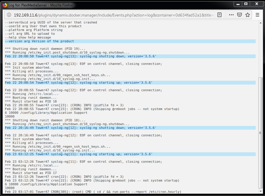

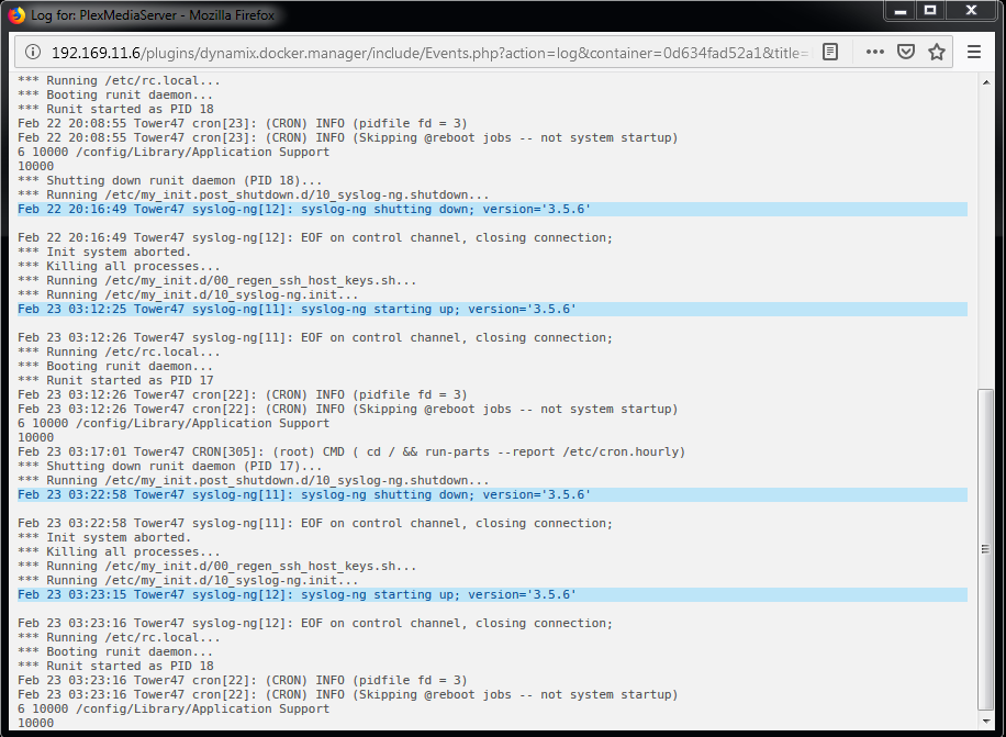

Well that didnt seem to change any thing but going crazy over this i am going over logs trying to see how this thing ticks and i notice this when checking out the plex logfile under docker tab.Log says its 3:17 Feb 23 but its 7:17 Feb 22 as time opening the log. Unraid has correct time in the time and date tab so where does plex read the time from?
The time zone can be set using an environment variable. Check this forum post about someone else on unRAID having mismatched times albeit with another service. Looks like there’s a few good diagnostic steps provided which may help get to the bottom of the issue
