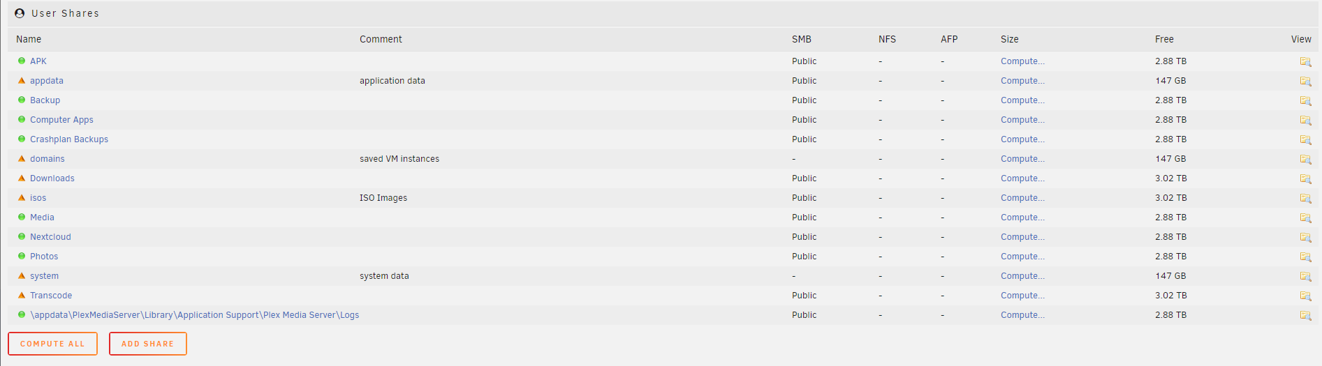

Tower emhttpd: error: put_config_idx, 609: Invalid argument (22): fopen: /boot/config/shares/\appdata\PlexMediaServer\Library\Application Support\Plex Media Server\Logs.cfg
Where is that path configured?     Back slashes in Linux are not folder separators in a path.
Is this what you were asking for?
Could this error be from a share? I see a share that is about the plex logs.
Go to Tools - Diagnostics and attach the complete diagnostics zip file to your next post.
I am thinking Plex isn't really the source of that message.
It is in your screenshot. You have somehow managed to create a top level folder named
on one of your disks.

It is on Disk1 according to your diagnostics. You must have somehow managed to copy that folder to that disk
2 minutes ago, trurl said:
It is on Disk1 according to your diagnostics. You must have somehow managed to copy that folder to that disk or to your user shares.
This might be a dumb question, but what is the best way to delete this share to stop the error?
I really can't quite figure out how you could have done it. Since it has the \ path separator in the name it must have been from Windows.
According to your diagnostics it has default settings, which means you have never gone to its page and made any, not surprising. I am just wondering whether the normal way of deleting that share is going to work.
You have to delete all files and folders from the share. Then maybe you can delete it from that share's page unless the webUI chokes on that name.

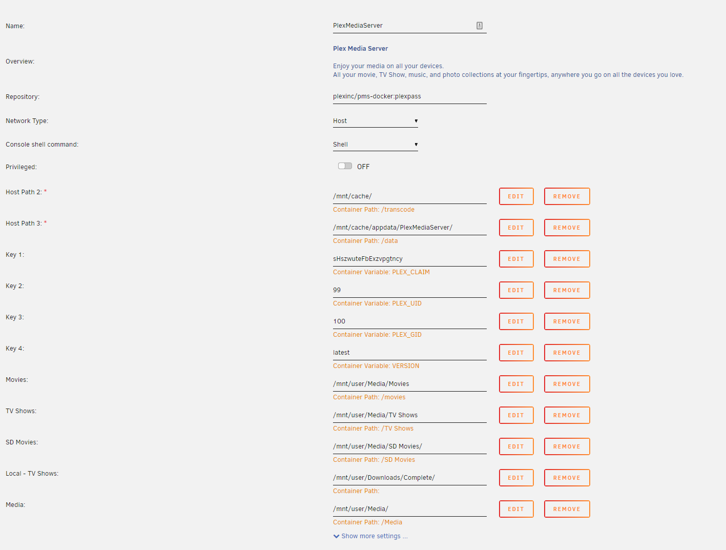

To begin with, post the contents. of /config/plugins/dockerMan/templates-user/my-PlexMediaServer.xml on the flash drive.
After that, it may be simply easiest with remove the entire plex app (along with its appdata) and do a fresh install of it.

The diagnostics don't give us enough information to tell you the answer.
Attached!

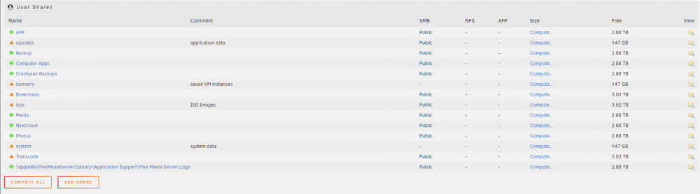

I just edited the Docker for Tautulli that had something for the Plex logs (It was that same thing that is giving me the errors).
I also noticed that the share I deleted earlier re-appeared. I deleted it again and will see how it acts tonight.
