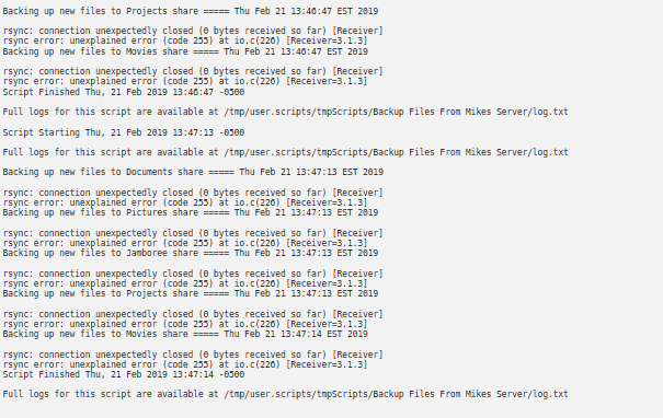

how do i avoid this rsync issue
ok I find  rysnc gives me this issue...  in the pic
but if I run the command line  of one of the steps in my scripts it will ask me  yes /no  to add the server to the I guess authorization  file
then if I run my script it will run ok
how do I make it so I don't have to run the terminal and run it manually... how can I make it soo script will automatically authorize
the first rsync command I use is
rsync -avzu -s --stats --numeric-ids --progress -e "ssh -i /root/.ssh/id_rsa -T -o Compression=no -x"  root@tower:/mnt/user/Documents/ /mnt/user/Mikes\ Files/Documents/ >> /boot/logs/cronlogs/Backup_Docs.log

like this ?
yes:rsync -avzu -s --stats --numeric-ids --progress -e "ssh -i /root/.ssh/id_rsa -T -o Compression=no -x"  root@tower:/mnt/user/Documents/ /mnt/user/Mikes\ Files/Documents/ >> /boot/logs/cronlogs/Backup_Docs.log
and not sure what ":" you using between yes and rsync   as yours different from what I just did.. but is that what I type
It is the "pipe" character. It is commonly used in linux and even DOS (Windows) at the command line. It basically means "take the output of this and make it the input of that".
That character is on my keyboard as shift-\

It looks like your known_hosts file does not contain the ip address and authorization key for the destination server as it should.  You are prompted to answer the question because it is not already authenticated as a known host.
You are running the same rsync backup script I am and a proper known_hosts is what prevents being prompted for the yes/no answer.
I assume you have something like this in the 'go' file of both servers?

nope didn't work  says broken pipe  I did
yes|rsync -avzu -s --stats --numeric-ids --progress -e "ssh -i /root/.ssh/id_rsa -T -o Compression=no -x"  root@tower:/mnt/user/Documents/ /mnt/user/Mikes\ Files/Documents/ >> /boot/logs/cronlogs/Backup_Docs.log

and like when I run the first rsync above...  in the command line.. I asked yes or no    so I do yes.. and then cancel
then once I run the script  it works   but every so often stops working and I get the error..

Make sure that after you say yes, copy the newly updated known_hosts file to your flash drive as it now contains the address of this new computer as a safe known host.  Then next time you reboot the server, have the go script copy this new known_hosts file into the root/.ssh folder.  Now you won't have the error any more and you can have the backup run by script in your /etc/cron.daily folder or weekly, or monthly or hourly if you really want with no need for keyboard entry.
Your other errors about rsync unexpectedly closing the connection are an indication of network instability.  If you get it a lot, this is something either on your network killing things, or on the broader internet.  Between USA and China I see this sometimes on my daily backups in /etc/cron.daily  I don't worry as the next day /etc/cron.daily runs again and always self heals the backups.

That is the issue.  known_hosts, when updated (this will only happen in RAM in /root/.ssh) after you answer 'yes' to authenticate the host, needs to be copied to known_hosts on the flash drive (/boot/.../known_hosts) so it survives a reboot.
@Hoopster  ok so I have to run the command first in terminal then copy it??
I did the command line... and then script works
but ok what changes in the  known_hosts file..  reason is..  I had this working before then I gave it to my sister the server.. then I had to refix  ip address and other issues unraid had.. and I brought it back on my network...had to also change usb key as she only had a trial  only had 15 days left on it when I gave it to her... so I copied it to a new usb  her to test it before she buys it  gonna purchase the 59 dollar one if she likes it  as her mini server is just 4 drives...
but does the known hosts save usb key or what does it save..
and I thought my go file copied to the root folder..as it was working a couple days ago.. I was rysncing…   but power went out and when it booted up  I wasn't able to rsync
