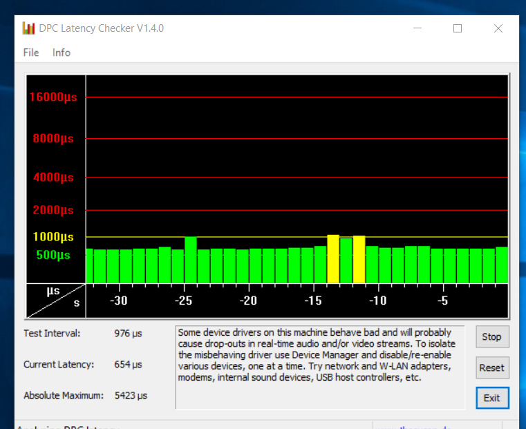

i'm seeing stuttering (cracking noises) in games and it's unplayable. My specs are in the post linked below.

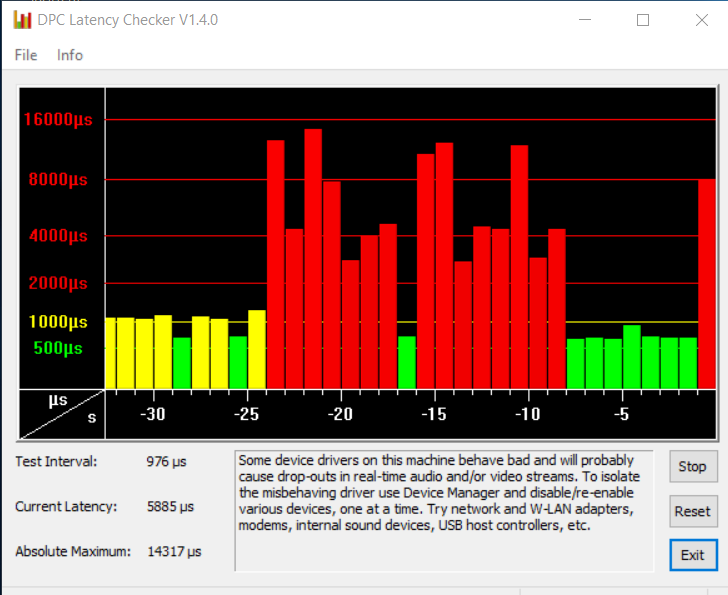

I'm using the latency tool and i can see spikes - in the video I show you my unraid cpu usage (maybe should have showed TOP), DPC latency checker and running 2 games.
1 game - apex legends uses multi core, the latency looks all the same. with the spikes.. (is yellow generally bad?)
in another game Everquest 2 which is old and single threaded, for some reason the average latency drops massively..
not sure if related.... still get the spikes though.
note the latency tool might not show a red spike at the same time i get stutter / crackle. but normally do..

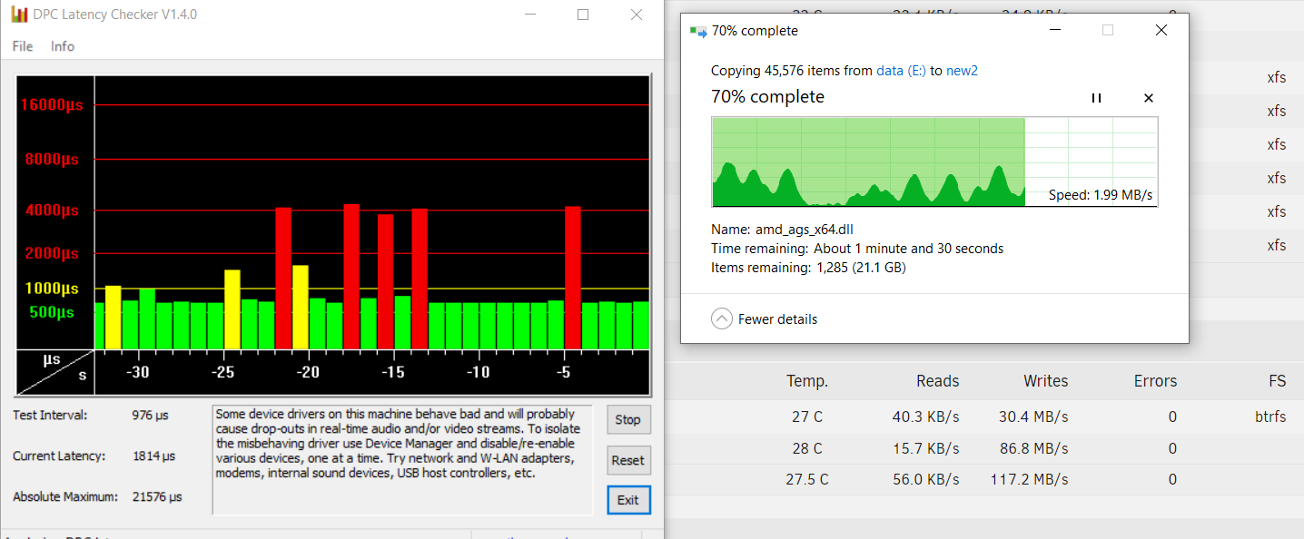

Copying from my nvme to a share (which uses cache), really locks up the windows VM + uses the first 4 cores like crazy.
even though the windows VM is isolated to the last 4 cores.
as i'm copying for my passed through nvme (controller) to the "share", this should mean it's not related to the virtual storage driver in the win vm? (which the OS is booting from - cache)
could it be my nvme itself?
i'll try disabling it and jut using the cache drive, and vice versa..

copying from the nvme (passedthrough) to c drive (which is on the dual cache ssd)
but.. getting still insane high latency when transfering files and/or download from steam at 40MB/sec onto passed through nvme drive.
with htep disabled it seems this is not an issue..

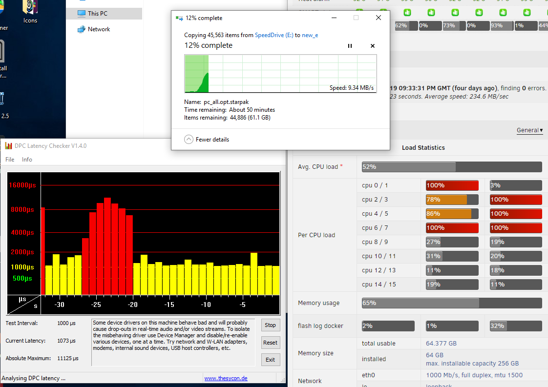

edit2: it seems it's if i copy to the array even not onto the cache. e.g. i have a share that does not use cache.. latency increases even if i copy to that... + i copied to a drive + parity that is not using my raid card, it's a drive + parities not using the raid controller (directly onto motherboard sata ports).
So -
issue is - whenever my windows vm touches the array, i get the latency issues.. whether cache or not, and doesn't matter if the drivers are on the motherboard sata controller or the raid card.
edit: it's only when WRITING, to the array (getting 100% cpu usage on emu cpu, and unraid cpus + copying goes to zero speed while it sort of catches up
OK:
copying via ssh (so all in unraid) from array to array does not affect latency in the windows VM
copying from array to ssd cache, causes a little spikes but nothing mega.. but still some.
i did notice something strange though - my isolated cpu i set for emu in the VM spikes to 100% even though i'm doing all this through ssh on a different machine.. it's not being used by anything at all except emu. why would that be?
seems latency is at it's worst on windows when  it's when writing to the cache or array, whether thats through a share OR if the vdisk is on the array/cache.
