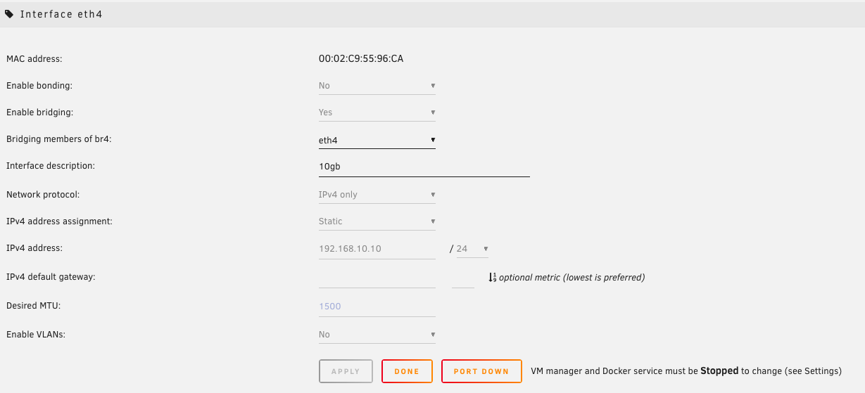

I have attached images of my network configuration for each unRaid machine.
545330116_ScreenShot2019-02-21at9_09_28PM.thumb.png.2cdf9cd57f73add53621ffa4f45133de.png

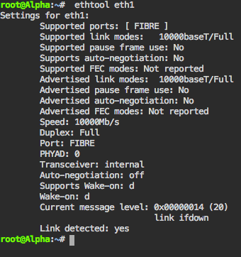

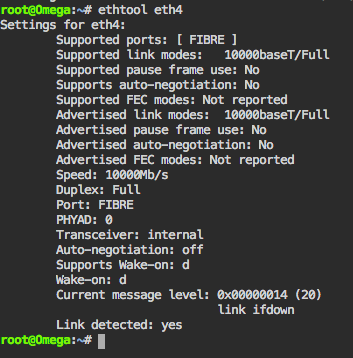

Below is an example of the error that I having. I also included ethtool results. Is there some magic setting that I am missing? I was also considering to include the 10gb card in the bonding group of the 1gb card; however do not suspect that is the best solution.
I would greatly appreciate any guidance/assistance on this issue as I have been pulling my hair figuring this out.
Feb 21 15:53:41 Omega kernel: mlx4_en: eth4: Link Down
Feb 21 15:53:41 Omega kernel: br4: port 1(eth4) entered disabled state
Feb 21 15:54:33 Omega kernel: mlx4_en: eth4: Link Up
Feb 21 15:54:33 Omega kernel: br4: port 1(eth4) entered blocking state
Feb 21 15:54:33 Omega kernel: br4: port 1(eth4) entered forwarding state
Feb 21 15:54:33 Omega kernel: mlx4_en: eth4: Link Down
Feb 21 15:54:38 Omega kernel: CIFS VFS: BAD_NETWORK_NAME: \\192.168.10.4\personal
Feb 21 15:54:38 Omega kernel: reconnect tcon failed rc = -2
Feb 21 15:54:40 Omega kernel: CIFS VFS: BAD_NETWORK_NAME: \\192.168.10.4\personal
Feb 21 15:54:42 Omega kernel: CIFS VFS: BAD_NETWORK_NAME: \\192.168.10.4\personal
Feb 21 15:54:44 Omega kernel: CIFS VFS: BAD_NETWORK_NAME: \\192.168.10.4\personal
Feb 21 15:54:46 Omega kernel: CIFS VFS: BAD_NETWORK_NAME: \\192.168.10.4\personal
Feb 21 15:54:48 Omega kernel: CIFS VFS: BAD_NETWORK_NAME: \\192.168.10.4\personal

One more thing to note is that I enabled bridging to pass the 10gb card to a VM. Not sure if this is part of the problem; I am thinking to disable bridging and monitor the logs.
