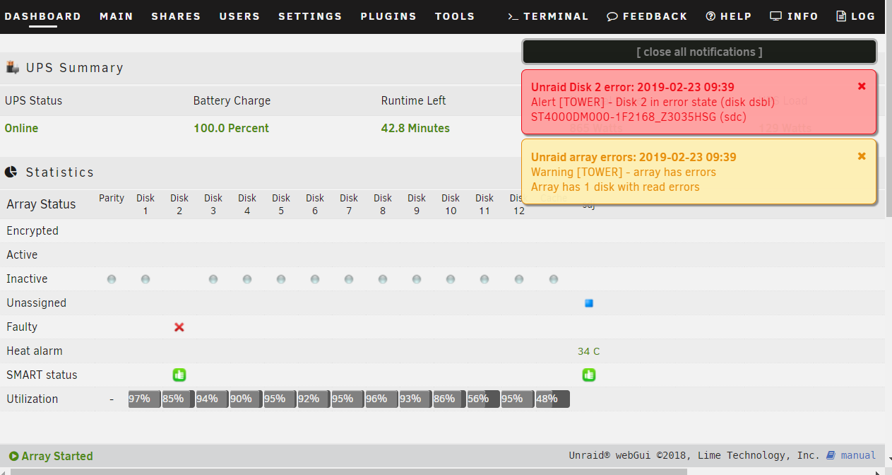

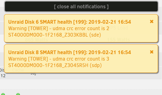

When the system first came up after upgrading it indicated that two disks had udma crc errors (see image001). I did some rooting around on the internet which seemed to indicate that such problems were related to the transfer of data from the disk to the host, and that the best course of action was to check out the connections on the cables and the seating of the disks.

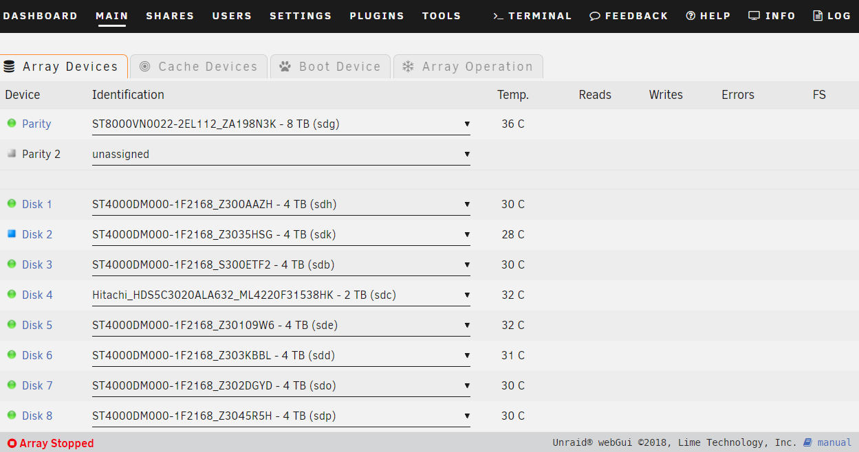

When the system rebooted it still indicated that disk 2 was missing but now the physical drive (5HSG) was now presented as option to place in the disk 2 slot (see image002). I once again shut the system down and rebooted.

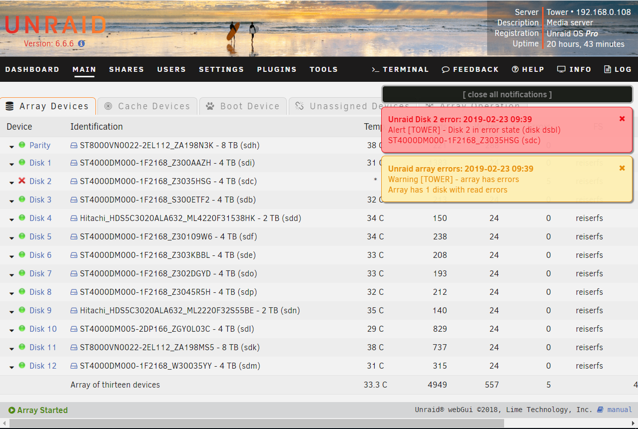

Again, disk 2 was reported as missing and in an error state, but now the disk was shown as selected for Disk 2. (image003). (this is the current state of the system and is the basis for diagnostics file that is attached to this post.)

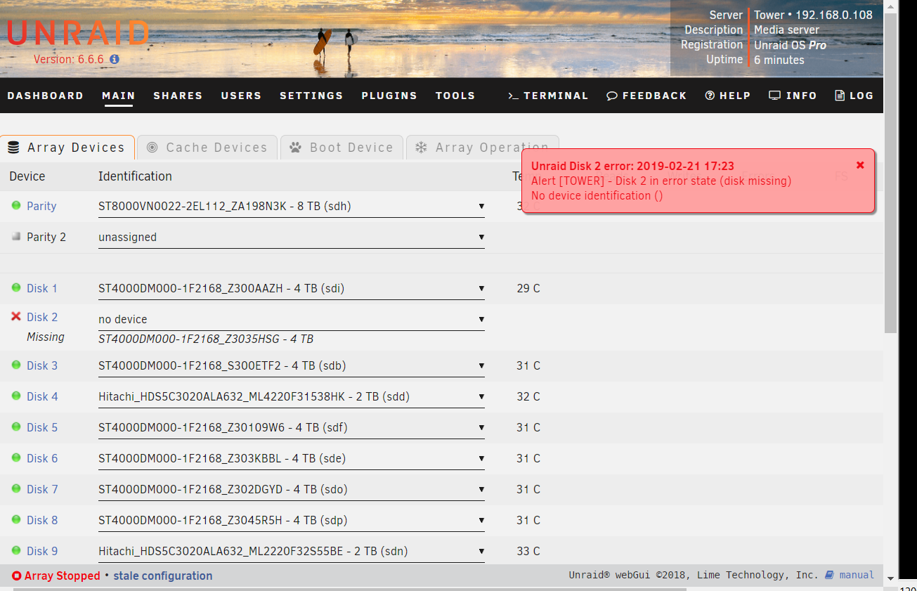

Thanks. I started the array, and received the following message (image004), and an indication of problems on disk2 in the Device column (the red 'X' on the left).
But the array itself seems intact. I can mount the array on my PC, and if I access disk2 directly from the network via the TOWER, I can see disk2 and access the content on disk2.
Can you advise what I should do next.
Thanks.
UnRAID has disabled disk2 due to a write error and is now emulating its contents using the combination of the other disks plus the parity disk (which is why you can still see its contents).   Once a disk is disabled Unraid stops writing to it.  However this means that the array is now unprotected until the problem disk is recovered back to normal state so another disk getting disabled would cause data loss so you want to get the array back to a good state ASAP.
The disk is quite likely to be OK as write errors are frequently due to external factors (e.g. cabling, power).    If you post your diagnostics zip file (obtained via Tools->Diagnostics) then you will likely get some feedback as to whether the disks looks OK.    The recovery process involves rebuilding to a good disk to get the physical disk back inline with the contents that Unraid is currently emulating.

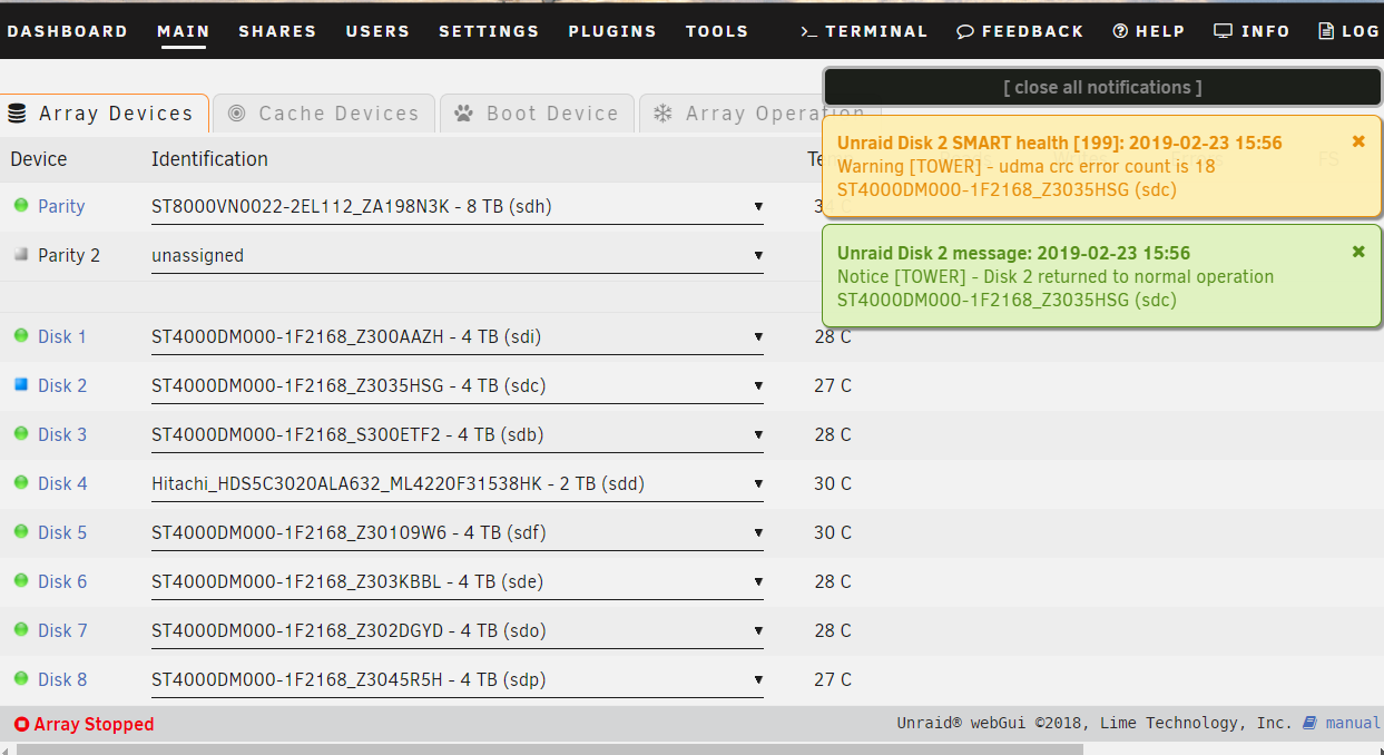

Anyway, I'll await the analysis of the diagnostic file, before proceeding. I, too, think there is nothing wrong with the disk itself, as prior to upgrading to 6.6 (from 6.1) there were no indications of problems, and SMART status indicates it's OK. (see image005). But, if there are problems with it, I've got an 8 TB hot spare ready to go. I just don't want to 'waste' that spare at this point if I don't have to, since I've got plenty of free space in my array.

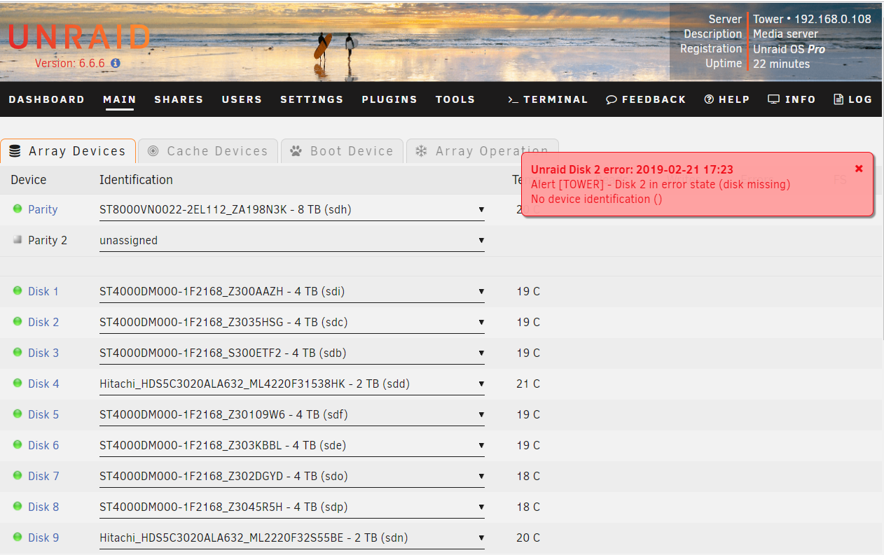

I followed the instructions outlined in reconstructing the drive, up until the final step of actually starting to reconstruct the drive. Upon re-assigning the disk I received a warning notice that there were udma crc errors on disk 2 (see image006).
So, I shut down the system, and moved the disk into one of the slots controlled directly from one of the SATA ports on the motherboard, and rebooted the system. This time I received no notices or warnings (see image007).
Now I'm left with a couple of questions and some decisions to make. If you look at the first post in this thread, immediately after upgrading to 6.6, I received notifications of udma crc errors on two other drives( drive6 and drive8. After that initial boot these drives haven't reported any problems). Those two drives are also attached to  SAS controllers but are on different cables from disk2 and different cables from each other. This would mean three of my four SAS cables all started reporting problems at the same time, since none of this was being reported until the upgrade to 6.6 (dumb question: does 6.6 perhaps incorporate diagnostics that are, in some way, more 'sensitive' to udma crc errors than 6.1?). It does seem odd to me that these errors would suddenly start to appear just after upgrading the OS, and to do so on three different cables.

UDMA CRC errors weren't monitored on v6.1, it started on v6.4 IIRC, just acknowledge those warnings, they could be old, but it they keep increasing there's still a problem, in that case the most likely problem is the SATA cable, then the backplane.
Thank you!  That's extremely helpful info, and explains why these errors are suddenly appearing, I'm going to try a rebuild and watch the array closely. As you say, if they keep increasing, I'll replace the SAS cables. Hopefully it's not the backplanes.
