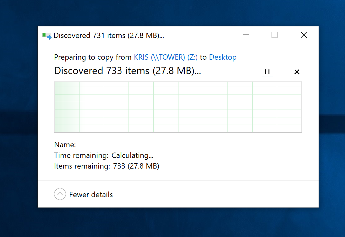

Hi, I have an Unraid server that has been running on 6.6 fine for a long time.  But now I am having issues with SMB copy's from certain shares.
If I copy from one of my shares it starts copying straight away @ 100+MBps but if I copy from my other share it will spend many hours "discovering"/"preparing to copy"  the copy will complete in the end but I have to leave it over night, I get the Same behaviour on 3 different computers on Wifi and ethernet.
Writes to the share seem unaffected.
Thanks in advance

here is the diagnostic zip and a screen capture of what I see for hours.
Another thing I have noticed is that I can transfer a large single file from the share no problem but as soon as I transfer a folder structure with many files it "Discovers".
fyi, The share that I am having issues with is K--- in the diagnostic and the M---- share is the one that's fine.
Thanks in advance

Iv have come the conclusion that the issue is due to the large number of files in the folders I am trying to copy.
so I think the real question should be, What is the best way to do transfers of large folder structures from a mapped network drive on windows 10? Im using the Sync docker at the moment that seems to work well but its not ideal.
