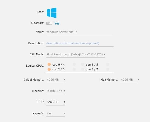

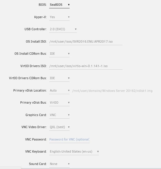

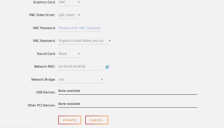

not sure how to show xml file but I took pics
ya maybe I better off just installing Win 10  as that computer has no issue with my Win10...  I put on shelf till I get another video card to try the 2 gaming machines 1 cpu…  since I still having issues with onboard video and my pci video card not workting right together...
but here is the screen shots for win server

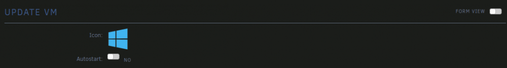

Under the assumption that you took the red pill and feel up to the challenge, then up above and to the right hand side of all the stuff you took a picture of, there is a little toggle switch for "Form View"
That is where you find the XML version of your VM setup...  Copy it all to a text file, and attach that file here...

Some things I can see you might want to try first though, make sure you are running UnRaid 6.6.7
Also, normally you want to run latter versions of Windows with the "OVMF" bios, not the SeaBios, but that can wait till we look for anything else...
