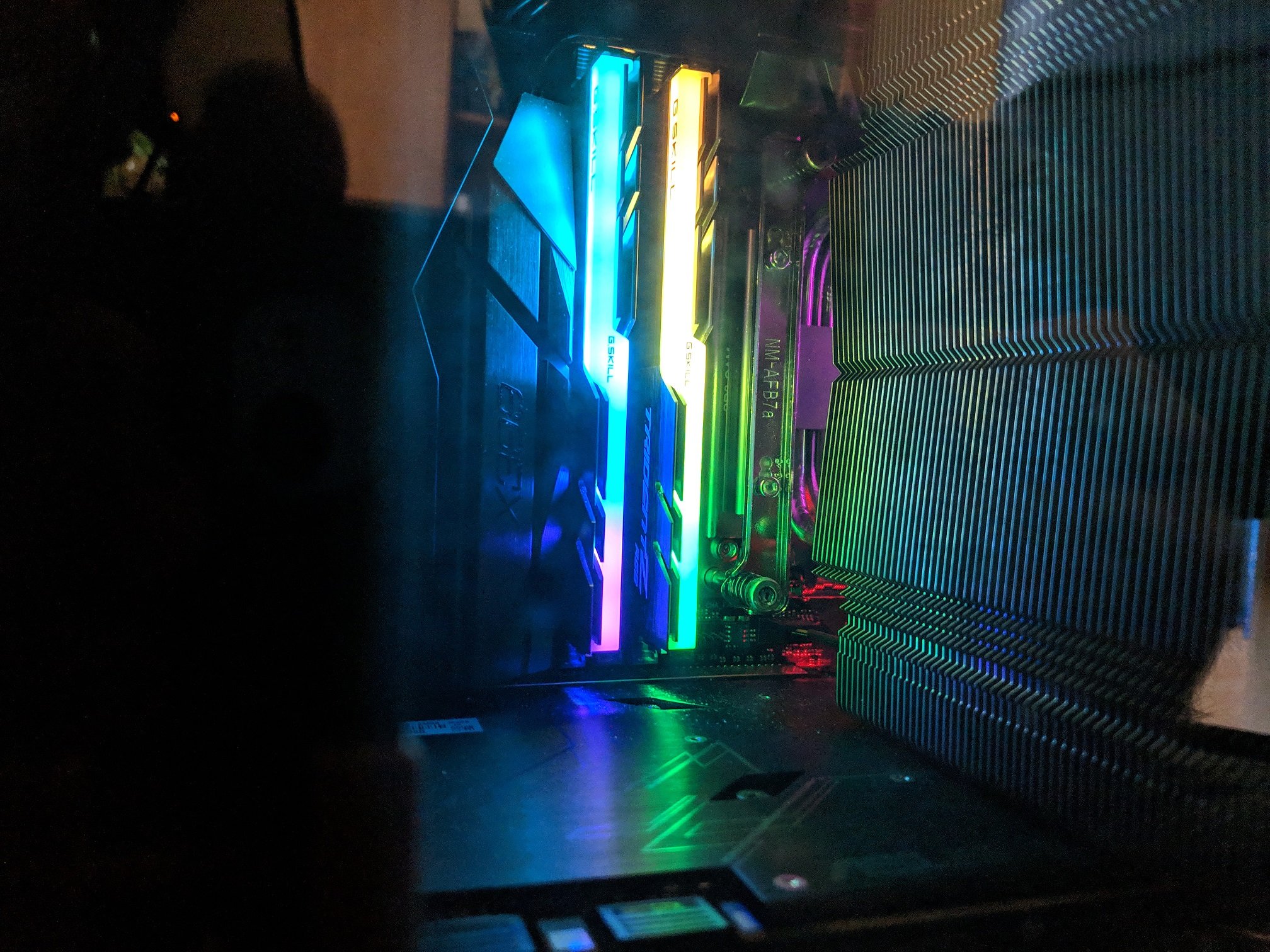

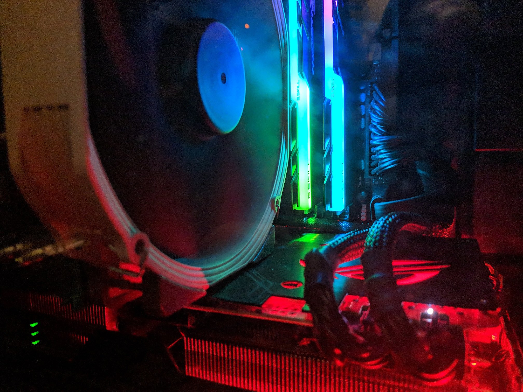

@Symon The Ram slots shouldn't be an issue to populate. At least for me it looks like there is space under the fan for another Trident Z. Luckily you can adjust the fan, also the cooler is adjustable a couple mm to get it more distance from the GPU. Has to be done when it's mounted. The thick ass Strix 1080ti fits in the upper slot with a 2mm gap to the cooler. I tested with the card on a lower slot. The temperature difference on max load is 2-3°C.
Sry for the dirty side panel 😂

Did you plan that before buying or just luck ? :D
Other users mentioned that the first pci slot on my MB would be covered by it .. but I might still try it if I can't get the current cooler to work properly with unRaid.. :)
@Symon I've had read that it should fit on most of the boards and depending on the thickness of the backplate other cards might be touching the cooler. Btw, a card with backplate you kinda safe and won't short something on the card by touching with the cooler and the plate is mostly only for design reasons. I never saw any temperature testings where the backplate of the card had any effect on the cooling of the card.
