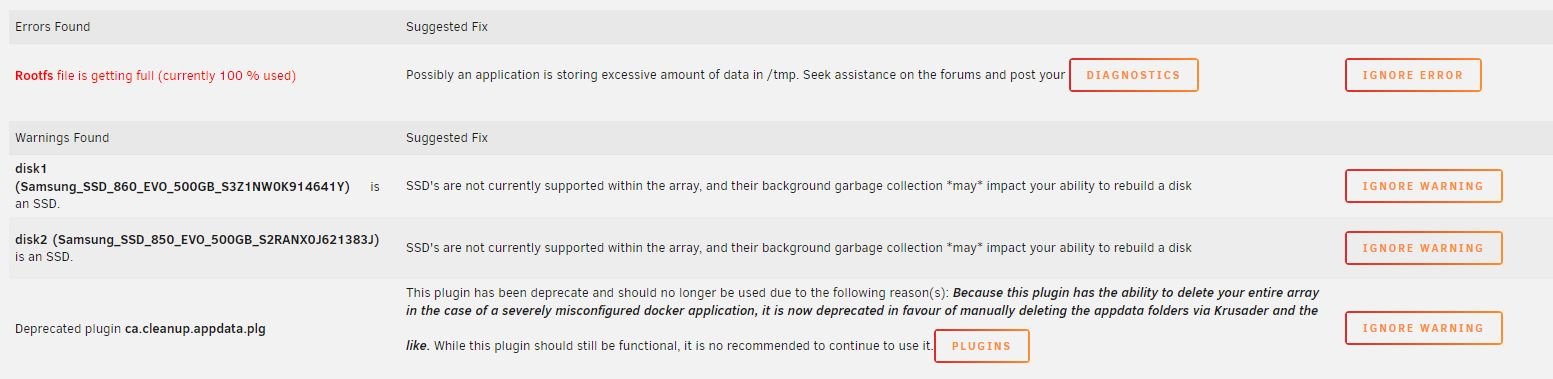

9 minutes ago, TODDLT said:
It looks like No Space Left on Device error.
Also what is the "no such file or directory" error below?
I am guessing these are the same cause and you have filled up /tmp
Post diagnostics which might clear this up as well as let us take a look at SMART report for that disk if it is responding.

Then I get a red error from "Fix Common Problems"  I am used to the SSD warning, but new items now show up.  one regarding the /tmp file.   Please see the attached image.  I have now removed the ca.cleanup plugin (and have never actually used it before).   What do you make of the error message because that seems related to the original comment you made about the tmp file being full.
