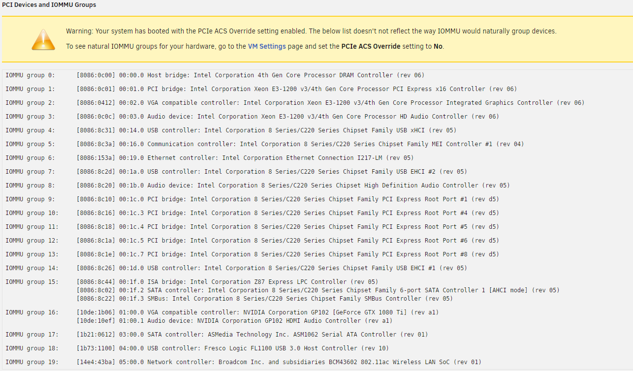

Can you post the system devices list with both cards installed?
Could be that there are a compability issue with the motherboard and 2 cards.

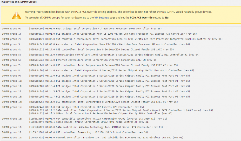

This List? (below image/text, both cards installed)
In this case I have append "vfio-pci.ids=1b73:1100,14e4:43ba bainitrd=/bzroot pcie_acs_override=id:8086:0c01"
(vfio for the Broadcom wifi and Fresco, pcie_acs_overrride for the gpu only)

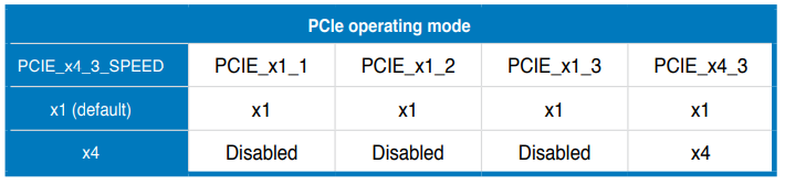

Looking at your motherboard, there are alot of pcie port sharing and some ports are disabled if you put card in X slot.
Take a look in the manual and check how the ports work.
I don't think that is the problem. The slots that share/disable each other are the PCIE_x1_1, PCIE_x1_2, PCIE_x1_3 and PCIE_x4_3 slots.
In the bios setting, I have already set the PCIe Operating mode to be x1 for all slots (instead of x4 for PCIE_x4_3)
Furthermore the Broadcom wifi card occupies the PCIE_x1_1 (top slot), and the 2 port Fresco card (PME-4UI) occupies the PCIE_x4_3 slots and they are detected and works properly.
Furthermore, as part of the earlier testing included swapping around the 2 Fresco cards between PCIE_x1_2, PCIE_x1_1 and PCIE_x4_3 slots, which still result in only the 2 port Fresco card (PME-4UI) being detected, not the 4 port Fresco card (PME-4U).
Admittedly I have not tried putting the Fresco cards into the PCIE_8x_2 slot (which shares space with the gpu) as I intend to fit an lsi card card there
