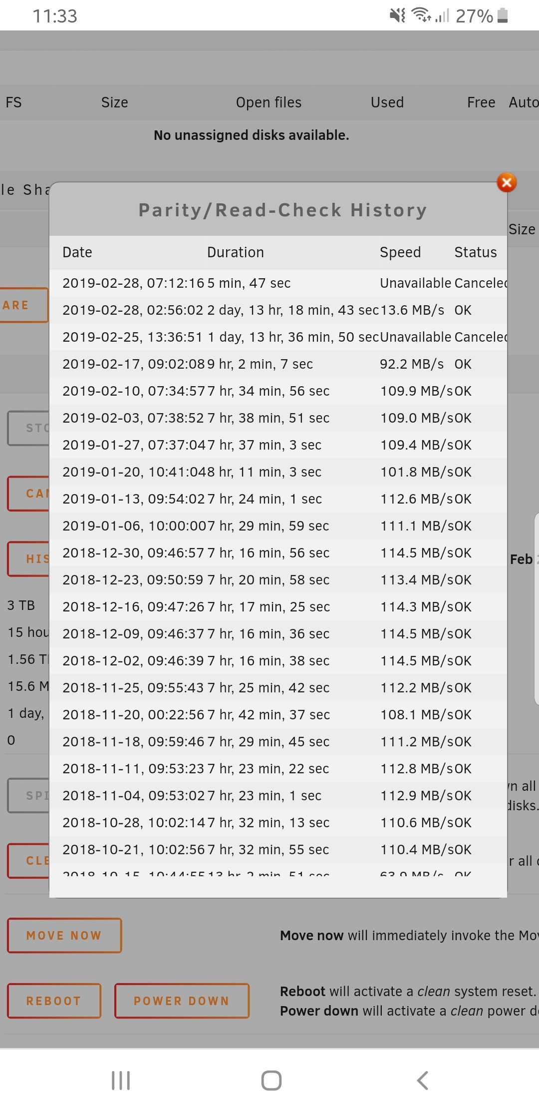

I don't know why my parity check is beginning to take 2+ days. Nothing changed, updated, upgraded. Same hardware same software are the previous times. Any help would be be appreciated.
Currently running a check, 15 elapsed, 24+ left.

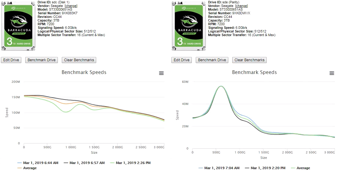

Nothing jumps out, parity has a failing now attribute, it might be a slow disk, you could try running the disk speed test docker.

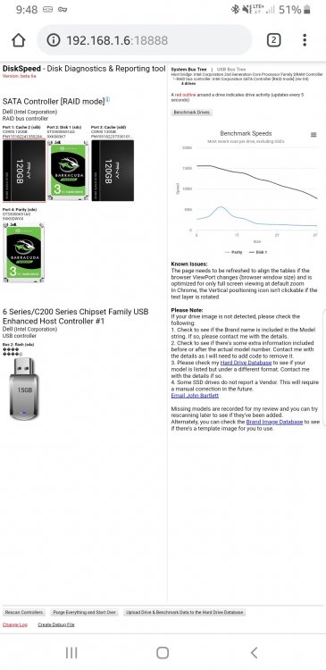

Here are the speed results. The only thing I can think of is that I added about 200gb of data over the past few days, but I don't think that should slow anything down...thanks.
Parity is clearly not performing well, and since:
You should just replace it.
Looking at the speed comparisons between Parity and Disk 1, there's a huge difference. I'll replace the drive. Thanks for all your help!!
