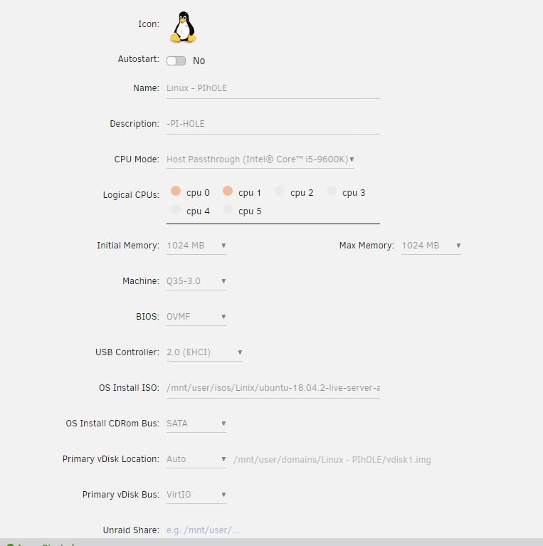

I am trying to install Unbuntu 18-04-2 Live server into a VM as I want to play around with Linux commands and stuff, but I am having issues in getting the VM created so that I can install the ISO.
the areas I am not sure on are the following.
CDRom Bus
Primary Vdisk
VNC Video Driver
etc

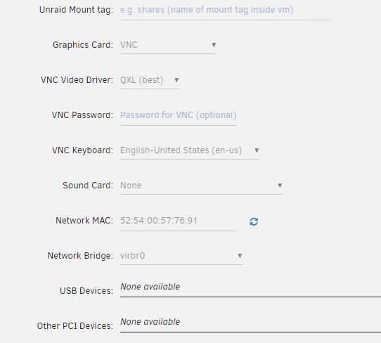

so I have taken a screen show of my settings. in the hope that someone can help me out.

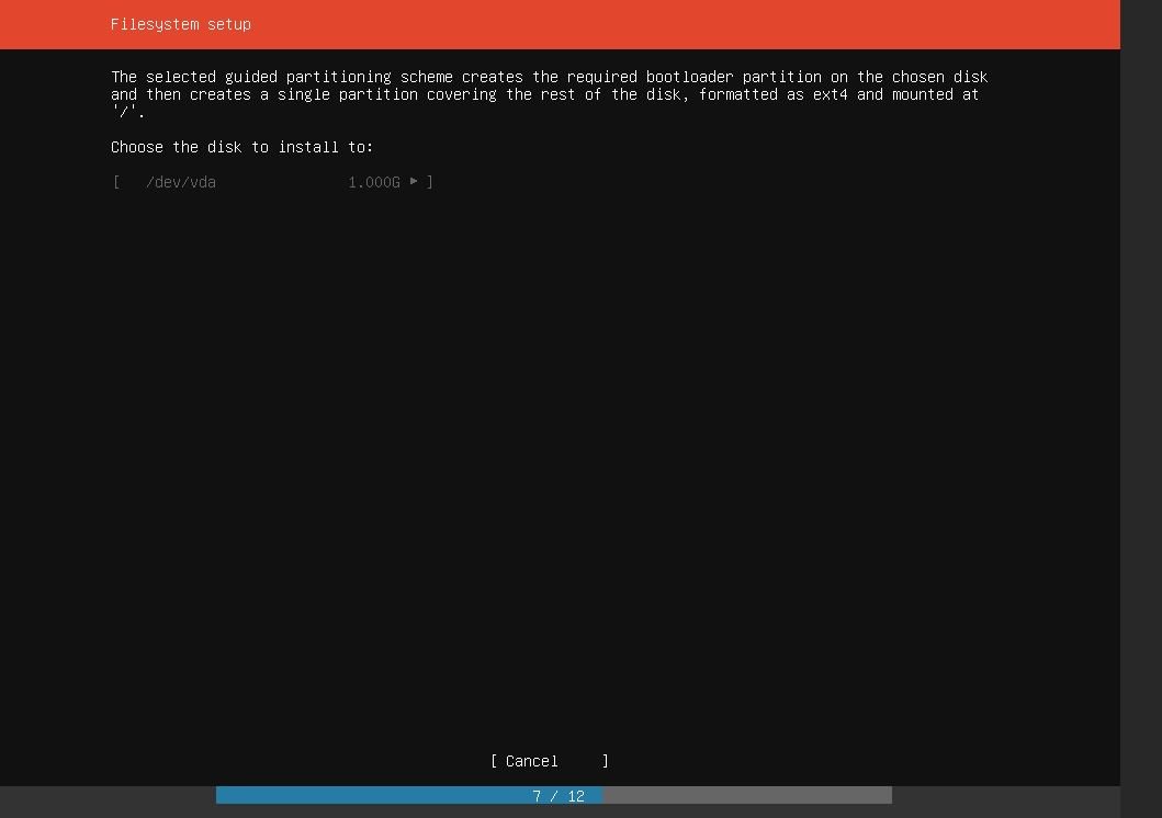

if the above is right, I have also tried to install it,
I have set the Keyboard and region to UK
I then choose the Install Ubuntu option
Ok to the DHCP of the IP
Ok to the proxy, and the mirror Proxy
and here is where I am also having a issue
then I choose Entire disk, , I am show my disk, but I am not able to highlight it and choose OK
what am I doing wrong.

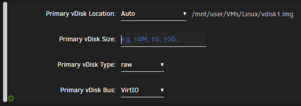

I bet your 1GB vdisk is to small to install Ubuntu on. When first creating your VM choose the right amount for the vdisk like 10G or 30G for 10GB or 30GB.
You don't have to create a new vdisk. Shutdown your VM and click the name of the VM and you can expand the size here. Change the value for capacity and you should be able to install Ubuntu. Small hint, never decrease the capacity this way or you will break the VM. The defaults in the settings should be ok. And better don't choose the first core and it's HT cause it's always used by Unraid.
